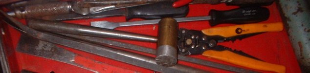

Id love one, but it would hurt the one i made's feelings.:)

Looks very fine, quality product. If I were to purchase one, I'd prefer a sharper knurling. But knurling's a personal thing anyway...
A
A_Pmech
May 8, 2007
8,002
IL
Vinko,
The knurling is sufficient to provide grip, but not impede tactile feedback as a heavily knurled surface will.
However, if you prefer a more developed knurl I can accommodate you. It is, after all, a hand-made product.
