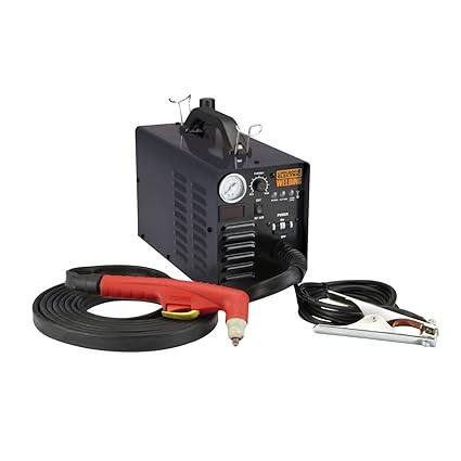

240 Volt 40A Plasma Cutter - Item #62204
Pass
After some research last week, and a cash donation from a friend, I picked this up and used it all day Saturday. It comes with a stand-off shield (not pictured) which helped a new user like me to keep the actual tip from touching the work. I was able to start cutting with it right away, and it cuts clean and fast. The sleeve covering the lead to the torch seems a little flimsy for a daily user, but I'll just use it on occasion so I'm happy with it so far. It sure saved me a bunch of time right out of the box.
