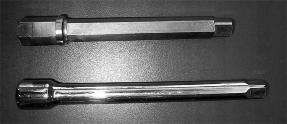

So I got an email from the guy behind the extension you see above...The "hexed" one, not the typical looking chrome job on the bottom. And while I've never used or even touch...

Neat. Still takes a 3/8" ratchet. That's all that matters.
The whole tool is hex space to grip on.
Maybe add a little knurling where that ring is.
I can see people buying this.

I think that longevity would boil down to how the "hextension" is made. Most hex keys sold on the market today use bar stock that they cut to length and call it a hex key wrench. Hex bar stock is extruded through a machine (like playdough) and this process produces a softer steel. The result is that the ends round-out quickly.
For a long life, they would need to take the extra step to “forge” the hex shape into round bar. This gives a more precise shape and it makes a harder end which will last a lot longer.
The only company that I know of that forges their hex keys is BETA Tools. I would definitely be interested to see how it holds up in a shop environment.

I like it. It states, "HEXtension features precision CNC consctruction of hardened 440C steel. The machined flats..."

I've never seen an extension machined that way either. It looks like it would come in handy in certain situations. I'm curious what the price of it is.

If the price is decent, I'd buy one. I can think of a couple situations where it'd be useful for me.

My name is Shaun and I am the co-inventor of the tool. It's great to get started with an awesome site such as this. I really appreciate Mohawk Dave giving me a ring. It meant alot.
We have a patent pending on the tool and it's an idea we have developed over about a year of yelling at bolts and fasteners under our cars. It really is our dream to start a company that concentrates on unique ideas and great customers.
To answer the question, we should have the first batch in by the end of the month. I am still waiting on the prototypes to test from the manufacturer.
We should have pricing soon.
Please let me know of any questions you have. We are excited to bring a tool to you that we have envisioned and finally created.

Interesting. I agree, the rounded lip between the 12 and 15mm hex needs to be knurled.

What's the COO?
If it's china a lot of guys here, myself included, won't be very interested vs a US made one.

Trust me I want a USA made tool. I like to drive nothing but American Muscle (except my Aussie GTO lol). We are working on new manufacturing soon. It's really a cost thing for guys getting started.
For now it is a full CNC body (no dulled edges) via overseas. The hardened steel is made on a full 4-axis machine job so no welded or "pulled" parts. It increases cost, but the tolerances are kept much tighter.
We will always offer a money back guarantee.
We kept the only bevel at the top where there is a 18mm circular section that retains a 15mm wrench on top. The center section is for resetting a box wrench in confined areas.
There are 2 versions. One 100mm and a shorter 50mm.

Thought about this, but knurling is only for grip. The hex grips better than any knurling.
I tried the tool with an oil and ****** change. Knurling works, but the hex holds your grip better.
Something to keep in mind though.
Great suggestion. Please feel free to post your comments.

If anything, it would make the tool look nicer;)

I like the idea and what its supposed to do. But I hate to be a sour grape, but what problem does this actually solve? I'm sorry I just don't see it.

Ok this is cool, and I can't believe no one though of this before. Made in America would make it that much more special for me too.
I'm interested if the price is right. I have dome something similar to some old extensions so that I can put a box end on it.

I would prefer a 13mm hex on the shank so you can use either 13mm or 1/2" wrenches on it.

When you cant get a socket wrench head on the extension or find a "good" angle of grip.
I can't remember the number of times this has happened.
Anyone work on LS motors and think of spark plug 7 and 8 knows what I'm talking about. Swivel heads are nice, but you still depend on being able to put a head on there.
Also, think about oily environments. Circular, even knurled, get dirty and don't grip. A solid flat plane with an edge will always grip better.
You have new axis of grip that's lost with circular extensions.
Not a "sour grape" if you have a reasonable question. Thanks for the opportunity to explain.

13 mm is nice, but almost everyone has a shorty 12mm. It's pretty standard in every tool kit. Also, much more common to have a ratcheting version handy.
Also, 13mm is thicker than the standard circumference of the usual extension. We wanted to increase accessibility rather than match what was currently available.
15mm head allows for a substantial increase in leverage and torque ability with a longer wrench. Also this retains a reasonable thickness to maintain material strength without decreasing accessibility to the head.

Your tool doesn't look finished. There's no plating on the part and there's still visible swirls from the endmill. I assume it will be finished? 400 series stainless will corrode and pit out if you do not give it some type of protective coating.

Although not hex shaped the full length of the extension, Toptul's wobble plus extensions have a hex shaped area around the female square drive end. Great for finger spinning or in a confined space, let you use a ratcheting wrench instead of a ratchet.:dunno:

You are looking at the prototype pictures. Final units will have a black oxide coating. The pictures should be replaced when we receive the latest models back. These units are also missing the center relief.
