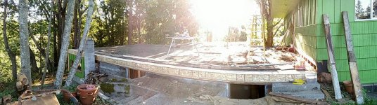

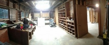

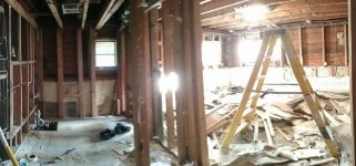

So, I finally got some time to upload some pics of my antics.
The first is of me removing the existing electric panel, and the next is part way through the install of the replacement.
My wife is a champ and has been taking her post work frustrations out on the walls that have to go while I am working on the less pleasant and or more technical projects.
We are working to clear out all of the gypsum board from the walls so we can update the plumbing and the electrical....and remove all of the rat corpses from the walls to help the smell.

I have finally had a chance to make some more progress on my garage.
My current focus is to level its(the garage's) roof and seal it up for the winter. In order to do so, I need unrestricted access to the rear wall which required the removal of some of the built in shelving.
Since I am at it, I decided to clean out the window wells which were full of natural matter mixed with trash.
After I got the window wells cleaned out, I started in on the roof jacking process which is requiring me to remove the soffit and blocking from the ends of the rafters in order to free them up.
Once I get the clearance I will be splicing the affected rafters and replacing the rotted out sill plate.
I built a composite beam and have positioned my jack to apply some force to lift the rafters once they are loose.

I have finally been getting some ripe tomatoes. This warm streak has helped get a few of them to ripen to the point of consumption.
As for my progress on my roof project, I finally got the decking replaced last evening and took some pictures.
I still have to put plywood over the window openings until I get some windows to fill the holes with, but that won't likely be for a while.
My plan is to spray the new construction down with Tempo SC Ultra (works great on bugs) and then fold the rubber roofing back over the exposed decking and move on with my life.
Next summer I intend to put up some walls and expand the kitchen out on to that newly leveled surface.
Here are a few pictures:

And here are the others that I took showing the decking installed:

And finally last night after I boarded up the windows and sprayed for bugs. I folded the roofing back over and have moved on to other projects. The roof should hold up till next spring I hope.
