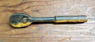

It was a donation from @jabberwoki. A wartime Walden 3150 rat with black oxide finish and some kind of unfortunate black gunk and a pelt of neon yellow fuzz on one side. It might have been cosmolene that hardened and also powdered or it's just a weird sort of rust or possibly a hybrid. Either way, it needs careful cleaning. On top of that, it's stuck, too.
But we gratefully accept the gift and the challenge!

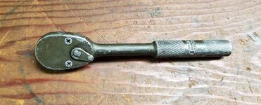

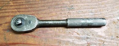

...don't lose those little screws!
Removing the cross-recess screws and putting them aside in a jar was the easiest part of the restoration!
The face plate did. not. want. to. come. out. Holding the ratchet by the handle, with the entire ratchet inside a ziploc bag, I was pounding it on the edge of my workbench just under the head, to try to pop it out, but it would only budge at the top a hair, and not enough to get something under it to pry it.
A lightbulb went on over my head and I grabbed a Waldes-Truarc snap ring plier 1340. Stuck the ends in the screw holes, squeezed hard, and pulled, and managed to get it looser. Then I put it back in the bag and pounded again a few times and it popped out.
Turns out the bag was unnecessary. The batman pawl is connected to the switch, which is pinned. The pawl does not come out. So the spring and ball have no way of flying anywhere.
Thankfully, nothing is worn or damaged or broken, it was just gunked up with hard cosmolene and rust.
I soaked the ratchet, the face plate, and the gear in SG for 15 minutes...
...then in Evaporust for 15 minutes (fearful of losing the black oxide finish), wiped it down with WD40, and it was looking much, much better.
Next I lubed it up liberally with Hoppe's gun grease...
...and re-assembled and it is working like new again!
And has a nice new cozy and cuddly retirement home with black oxide kin in this set.
Thanks @jabberwoki !

..not overworking it...
Thanks. That was the tricky part. The yellow fuzz was gone in minutes, but the black crud was stubborn. I could've just let it soak overnight in the Evap, but I don't think any of the black ox would've survived. So I had to use quite a bit of selective, careful, abrasive rubbing with a few different very fine files and rifflers. I knew I was going to lose some finish anyway, but I'll take the slightly worn but well-kempt look over rust and crud any day and I'll take it over grinded and polished to a mirror shine, too.
So stoked it's where it needs to be and completing a set is just a bonus.

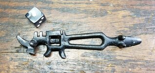

This example of the Woodward Combination Tool, a standard fin de siecle junk drawer item, is missing a cutter and corkscrew (you can see where it snapped off), but anything with a patent stamp this early ("PAT. AUG." / "24. 75") (August 24, 1875) is bring-home-worthy in our book.

I discovered that these were made at first by New England Novelty Works, later known as Woodward Glass Cutter, Inc., in Hill, NH, and then, after merging with Landon P. Smith, Inc., formerly of Smith & Hemenway fame, by the even more renown Red Devil, of Irvington, and then Union, NJ.
The top is an ad from an 1877 trade journal, and the bottom is from the 1934 Red Devil catalog (c/o @four.cycle!) It's amazing how little it changed over the years.
