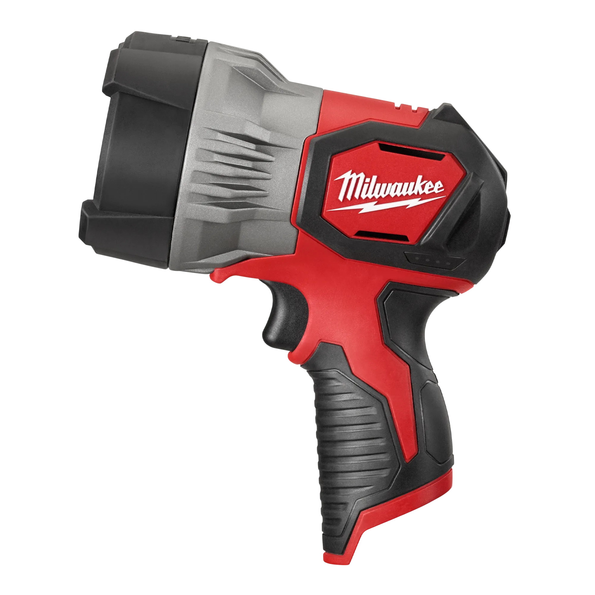

Bought the M12 spotlight. I needed a bright flashlight for use around the house when checking the front and back yard for wild animals etc. Wanted rechargeable but the batteries had to be replaceable. Ended up deciding to give the Milwaukee a try after watching a few youtube videos. Really like it! Very bright and it really reaches out there. Recommended.
Odd-job
Aug 13, 2017
2,327
Thanks. No, not as simple as that.
Nose cone, circuit board coating removal, de-soldering/soldering led wiring and also bushing/spacer made for inside the anvil to the impacting assembly.
Dang. I guess I don't want one that badly. Am wondering if Milwaukee does this on purpose as I would think less parts would equal more profits, but maybe they make more profit off people that get the 1/4 impact which they overcharge for? :headscrat I did a mod once an an M18 hex impact and the $40 nose cone killed it for me.
mikeinri
Nov 29, 2019
8,411

toyotadriver
Dec 30, 2010
1,586
Model number?
Mike
https://www.homedepot.com/p/Milwauk...andheld-Spotlight-Tool-Only-2353-20/206463136
