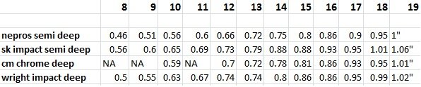

i use impact almost exclusively. i have chrome, but almost all of it was purchased many years ago. i needed tools, and as a kid, tools == craftsman (chrome, specifically). that said, in another, similar, thread, we discussed the 'impacts are too thick-walled' for everyday use. i actually measured a few sets - http://www.garagejournal.com/forum/showpost.php?p=2355393&postcount=9
while the impacts are MOSTLY larger, the difference is, in almost all cases, tiny. half a tenth or less in many cases. i can't recall a single instance where the wall thickness of impact vs chrome impacted a job in my experience. not once. i don't doubt that there are instances where it matters, but i'd posit that a particular brand/size of impact might be NARROWER than a different brand (same size) of chrome. point being - i don't buy the 'impact is too thick to use everywhere'.
