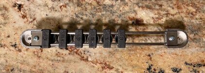

Does anyone know if one can disassemble the Nepros socket rails to add/remove individual clips?

To disassemble the rail you just have to remove a screw on the bottom.d6055bb6c060d92eec39f05d751d9185.jpg
