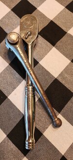

Yes, you read that right. I recently picked up a Pickop "Pick-Up" ratchet-wrench, and one would be hard-pressed to make up a story more eponymous than the story behind this tool, even if you tried!

The inventor’s name was George B. Pickop. The patent (847,601) was granted on March 19, 1907. Attached (see Pic 1) is the patent summary from DATAMP.
As you can probably already see from my photos in post #1, further shown by the action illustrated into the patent diagram, the ratchet works by turning against a fastener, then picking up the handle and moving that “lug” (as Pickop called it in his patent application) to one of seven notches in the geared socket for a new purchase, turning again, picking up the handle and moving the lug to a new notch again, and so on.
Simple open-geared ratchets don’t get any simpler or more open than this. In this case, the “gear” is actually built into the female drive member and the backward swing is freewheeling.
Naturally, then, Pickop called it the Pick-Up.
It was manufactured by the New Britain Manufacturing Company for at least 10 years, from 1908 (see Pic 2) to 1917 (see Pic 3). (Note: This is not that New Britain tool manufacturing company, which was New Britain Machine Company.)

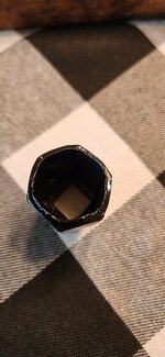

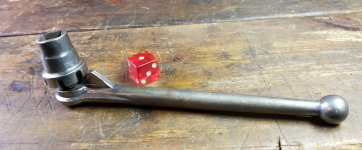

The female drive opening is 1/2-inch (see Pic 1). Ads indicate that it was made in many different sizes, from 4 inches to 24 inches (so there are some big ones out there somewhere!), with fixed geared-sockets of many different size hex service openings and depths (for spark plugs) to suit the size of the handle and vice versa. Ads also indicate it was made as a ratchet-wrench for a large automotive set that contained 31 sockets, a universal joint, two screwdriver bits, and two extensions in a wooden box. I believe that is the ratchet I have, and I would love to find the whole set!
As you can see, it requires a 1/2-inch drive male drive plug of some kind (universal joint, extension, etc), because female ratchets had 11/16” openings to accommodate pressed steel sockets with 11/16” male external drive tangs. (Their internal drive opening was 1/2-inch.) I am demonstrating in Pic 2 with a socket, universal joint and extensions borrowed from my Allen Wrench and Tool Company “Universal” No. 51 set.

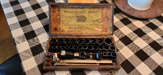

A little backstory: The men on my dad's side of the family all have a few things in common dating back multiple generations - we all were in the military and/or law enforcement and we all are mechanically inclined. My dad retired as a tank mechanic, and I'm a mechanic on anything from construction equipment to cars to lawn mowers. Tools are very much part of our every day and our hobbies. When I was in my late teens, my dad pulled out this old ratchet set in a wooden box and said he was going to clean the grease off of it and one day he would be passing it on to me if I was interested. Instantly, I knew there was something very special here and told him YES! He didn't know much about it, and estimated it was probably from around the 1940's or so. We tried looking into it online a little over the years, but we've never found anything about it anywhere online. We've just known it's old and has great character. Well, now my dad is getting poor in health and he decided it was a good time to get it to me while he's still of sound mind before anyone else gave it away or got to it.
Now it sits in my office on top of the secretary that was rescued and refurbished from my grandparents farmhouse (If y'all know anything about this secretary, feel free to chime in!). This set was my great-granddads, who gave it to my granddad, who gave it to my dad, and now it sits with me. I hope to one day pass it onto my son.
I just happened to try searching with the right keywords today, and it brought me to this post! Then, I found the post on papaswrench which led me to Alloy Artifacts. I also saw the patent listed on DATAMP today. I will be taking all of this info, printing all of the pictures shared on here and AA in color, and putting together a little folder of info about this set to keep with it.
You already have all the info down regarding the origins of this set. Now let me provide some pictures of our family "Pickop" Pickup Ratchet Wrench Set.

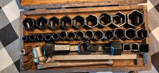

One of my favorite things about this set is just how rugged and imperfect it is. There's so much character to the ratchet itself as well as each socket and attachment. I don't know why, but I get a kick out of how the hole isn't centered perfectly through this weird big attachment. You can tell someone centered that on the drill press by hand. The metal also wasn't the strongest. Maybe I'm just spoiled by our current day tools, but I would be scared to use this set with any level of pressure.
I added some pictures of it next to a modern 1/2" drive ratchet for comparison.

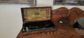

My dad is a bit of a woodworker as well as mechanic. He saw that the original box was falling apart, so he decided to make a replica of the box out of newer wood. The one thing he was never able to do was replicate the label. If anyone can help me find a picture of the original label that's not in rough shape, I have access to a pretty good print shop that can replicate it for the new box.
There's no intention on getting rid of the original box, and I even use it while this set is on display in the office. But, it'd be cool to add that final touch to the box my dad made at some point.

That set is beautiful. First of its kind here. The adaptor with the leaf spring for the screwdriver bits is interesting. Also interesting that most of the pieces got the black rustproof finish, while others did not. The set is very typical of an early mechanics' set in terms of the style, make, number, and sizing of the sockets and accessories. I have a dozen or so from the same era. But they all have a mechanical ratchet. Coarse, but geared. The other New Britain and the other Crescent enterprises devoting so much effort to making and marketing a large set centered around this plucky little manual ratchet is truly unique.
Thanks for posting the backstory and so many photos. Yours and your father's treatment and display of this set befits its admirable history.

As for finding an image of the label in original condition, that could be nigh impossible. Try Google Books. It might be in an old periodical advertisement.
There is a guy I know who might make you one from the old one. He's actually in a different hobby but has made me a few one-offs. I will send you that via PM. And there's another guy on ebay who makes them. Typically, he makes popular, in demand decals, but might recreate yours for a price. I have never used him, but others here have. I will tag @Oldtuleguy , who can provide the contact.
