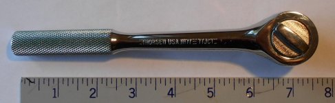

Lugnutz -
re: "Action" -
Let me back up a bit here regarding "finish". I'm not really rowing with both oars in the water, it seems.
I have a tiny bit of "Action" (one 3/8" drive set, as I recall), a ton of Thorsen, and way too much Giller.
I do have a lot of Thorsen and Giller 1/4" drive stuff that one would call "satin" finish - mostly the little tiny sockets. Also the sliding T-bars, breakers, and some extensions would be called more "satin" than "polished".
Almost all of my 77MC ratchets have what one would call a "satin" finish as well.
So now that I actually think about it (without going out and opening up a bunch of boxes), the only "plated and polished" stuff I can think of off the top of my head are the larger (3/8" and 1/2" drive) sockets and some of the drive accessories.
That said, I just received a Thorsen 77JCT that's got fabulous chrome plating, but it's clearly apparent it wasn't made by Thorsen:
Thorsen 77JCT 3.8 drive ratchet 01.jpg Thorsen 77JCT 3.8 drive ratchet 02.jpg

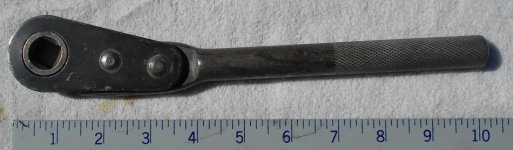

And finally, here's my question (not worth starting a new thread for this one):
I recently acquired a New Britain NM55 1/4" drive RHFT ratchet that is wonky.
I completely disassembled, cleaned, and reassembled it, but I cannot get it to work in both directions.
I found a couple Blackhawk repair kits, both of which contain the internal snap ring, but because the photos are so poor I cannot even guess as to whether or not they'll suit my purposes.
Here's the repair kit that I think might work:
https://www.ebay.com/itm/3-PIECE-1-...e=STRK:MEBIDX:IT&_trksid=p2055119.m1438.l2649
I sent an inquiry to the seller, who is being less than helpful. I would imagine he doesn't want to deal with hassling over a return, which is understandable.
If I could find a photo image of a Blackhawk GW9945A on Google Images at least I could make an educated guess, but I've hit a wall on this one.
Anybody have any clue on this? The kit's only $8 bucks, so it's not like I'm out a ton of money, but if it's not even close to what I need I can simply return the ratchet to the seller.
Let me know.
Not sure if this is what you're looking for. I don't see an 'internal snap ring' anywhere inside the Blackhawk ratchet. Let me know if you need/want more pics. :beer:
30,058
okay, so the worst that's going to happen is.... what?
will it matter if the replacement innards are single-pawl or dual-pawl? will either one work in the same ratchet body?
sorry if that sounds like a stupid question, but generally when I pull them apart and put them back together they work just dandy. this is one of two in the last two years that I've just not had any luck with.
(the other one's an older Indestro 2875 1/4" RHFT that's sketchy but I just got tired of screwing around with it and said "good enough".)
a whole $8.25 isn't going to kill me... I'm thinking I should just order it and cross my fingers. :wtf:

I guess it would help if I showed you guys what I'm working with here:
New Britain NM 55 1.4 drive RHFT ratchet 01.jpg New Britain NM 55 1.4 drive RHFT ratchet 02.jpg
Take a look and give me your best guess as to whether you think that kit I posted the link to above will work. Thank you!
and Thank you, D42Jeep - as I said above, sometimes other stuff has to be given greater priority due to necessity. ;)
BK
12,116
Okay. Chances are it fits. It's the correct style kit, just not sure if there was any variation in tooth count in either NB or Blackhawk.
Husky is the one I know for sure had two different tooth counts in their version of those round head, in 3/8 drive anyway.
30,058
Thank you! I'm going to go ahead and order one and cross my fingers.
