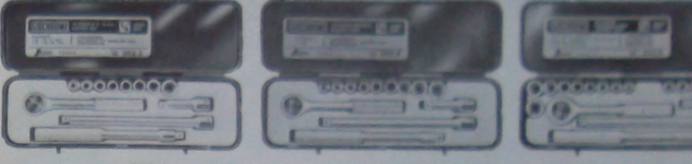

Here’s a “set” I have. Why would you use a power bar that is shorter than the ratchet?
This set omits the next two sizes of 11/16 and 3/4W which are often the most needed sizes on English cars.
I have an English car set-biggest spanner in that is a 7/16W, probably more of a Handy set and buy a larger size set for the garage ?

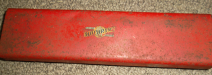

So my oldest Whitworth set is actually a A/F set with Whitworth Fences- may actually have 2 older Whitworth.
Sidchrome Forged sockets with scalloped edges, Cadmium plating. the Breaker bar is also the only one I have with Sidchrome Forged on it.
The very first of the Sidchrome sets, came out in Whit and A/F, late 1940's- 52. This is a A/F
The reason I call them Whit fences is the Whit sockets don't fit in the A/F fences.

And what I thought was 2 different steel gauges in the early sets is 3, I'm thinking the heavy gauge tins are earlier.
Just a really solid tin, 570gm, 520gm, 320gm ( tin only) rounded corners. all the later sets are in the lighter gauge apart from some 3/4 and assuming 1" drive sets.
Sockets are Sidchrome Forging, no scallops, One Cadmium plated, one chrome Plated set.
Dropped the Forging around 1952, later ones only have Sidchrome on them.
Heavier gauge, Whit sets
A/F set1725574898373.png1725574941314.png cadmium plated, no scallops, Sidchrome forging. sockets
These 3 sets were tin only when delivered, so can't really say without the tools what age they are, I would guess they should have the scalloped Sidchrome Forging sockets, Not anywhere near as common as the lighter gauge sets, which lead me to think they are earlier as well, but could just be a different tin maker/run out of lighter gauge for a while, Military issue ?
