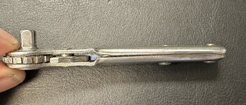

Over the weekend, I found these tiny tools hiding in my shop: a 4" 1/4"-drive ratchet of unknown origin (if anyone can help) and a 2 1/2" A. Plomb 6-point wrench. The ratchet works perfectly - I just don't know which manufacturer drawer/chest to store it in!
Edit: I just added a couple more photos of the ratchet, if that helps.

28,499
^ looks almost Oxwall-ish but the handle isn't quite right. might be a Japan-made knock-off of the Oxwall? :headscrat

Thanks BK. I just added a couple more photos of the ratchet from different angles, in case that helps with the identification. It certainly could be a Japanese knock-off.
