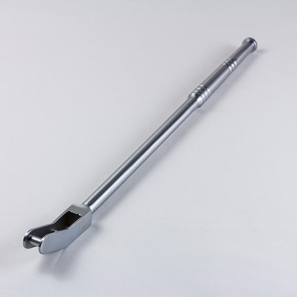

I have double wrenched a few time with no ill effects to the wrenches. I did see this on another forum and will make one when I have the need for one again.

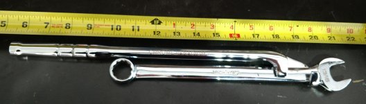

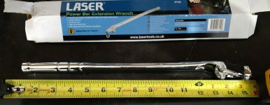

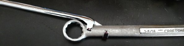

I ran into a situation a while ago while working on my beater car where I couldn't quite work a double wrench because of clearances and my ez-red wrench couplers weren't working either. I was set on buying a mueller kueps extender for this once-in-a-blue-moon situation but after reading some negative reviews about the finish and the tool breaking I decided to look for other options. I used the picture in Mr_B 's post to find this tool and decided to take a chance on it. Anyway, I am not looking to start any more debates about "is it worth it", because to me - if I get stuck while tinkering on my vehicle and pull this out once to use - then it was worth it. I just wanted to post information so others can make an informed decision if they decide to go this route.
This is a Laser 6745 Spanner Extension Wrench. Cost was 22.85 pounds from the tool academy. Shipping was 15 pounds to the US, because the shipping quote remained the same I ordered a second one as a gift for my father (a mechanic) for christmas... so the total cost for two shipped to PA was $78 (cheaper per piece than the mueller by any deal I could find). The order took 13 days to arrive despite being placed on a weekend.
I've attached some pictures to demonstrate size and show the connection end, I'm posting these because I had a hard time finding good pictures when I was looking for the tool. I couldn't find a country of origin, but based on the "chrome vanadium" lettering being similar to some HF tools I have I will assume China or Taiwan. The finish is excellent with the exception of one spot in the handle groove as shown.
I doubt I'll have a need for this anytime soon, maybe my father will be able to provide some OE down the road considering he'll probably use his first (once I give it to him).
What I like about it:
- The finish, and the handle is comfortable.
- The handle is shaped so I can slip a longer cheater bar on it if needed.
- It fits my jumbo wrenches right up to 1 1/2 - although that wrench is what I would consider super-jumbo.
- You can slide it up on the wrench if you need to shorten the extension.
- It keeps the stress on the wrench beam. (standard size wrenches)
- You can use it on either end of a combination wrench.
What I don't like about it:
- It's loose on the small wrenches - although this is expected since it is one-size fits all. I'm sure if I get into a tough situation a piece of rubber around the wrench would keep it in place.
- It's loose on my low-profile dewalt ratcheting wrenches, I'm not sure how they would hold up using an extender anyway so that would be a worst case scenerio.
- It will still put force on the wrench end for Jumbo's as shown.
Feel free to post any questions if I missed anything - just sharing to expand community knowledge.
Who knows, maybe I'll buy a mueller for comparison - or if I find a distributor for this variation of the mueller: http://www.welzhwerkzeug.com/products/product_view.php?product_id=1743
