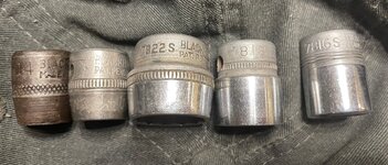

So these are all a little bit different from each other. Left to Right, an 814, a no tool # but in a 78XX style pat. pend. , a 7822S Pat Pend. A 7818S Made in U.S.A., and a 7816S but in the style of a 30XXX. socket.

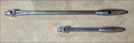

An old caterpillar service set
