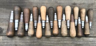

I would guess that those Lutz style handles were an add on. They were added to a huge variety of tools.
Don,
If by "add on" you mean a user mod, not a factory mod, that was my first thought, too. It looks like the cross-bar (detachable, 8" long) went missing, and this was somebody's inventive solution for an alternative.
My only pause is the strange model number. The model number for the 1/2-inch drive Tee-Bar was 9412. There is no 9312 in the Blackhawk 1930 or 1935 catalogs, let alone a 9312P. The whole tool was dropped by 1937. If that's a 1/2-inch drive Tee Bar, could it have been some kind of special with that different model number??

Don,
That's what I'm thinking. Its way too clean to be a mod, unless the dude (or dudette) was a true pro. I think it's real and now I'm on the hunt! Yes, 1/2" drive.
16,773
I'm still not convinced. There is a good reason that wood handles are almost never seen on a drive tool. The first stuck fastener that Tee encountered would be the end of it! If I see one in a catalog I'll be a believer. Until then not so much.

I can find no reference to a 9312 either. It may or may not have come that way, but looks awesome!
16,773
They are part of the WW2 toolsets that I collect, so I pick them up whenever I see them. For my regular modern files I prefer Shurgrip handles that hold securely to the tang.

31,069
Let us know what you find out, if anything, Todd.
I am on the fence on this one. My first inclination is owner's mod. I said the odd model number gave me pause about that, but, there could be other reasons for an odd model completely unrelated to the file handles. And note that those are unmistakably Lutz tool and file handles, as Don alluded to. That's also a little strange. If it's factory, they would need to be buying them from Lutz or have some kind of licensing arrangement. If you buy the Tee Bar, let us know what's under there. I am guessing the tool and file handles are stuck on the ends of a much shorter tommy bar.
