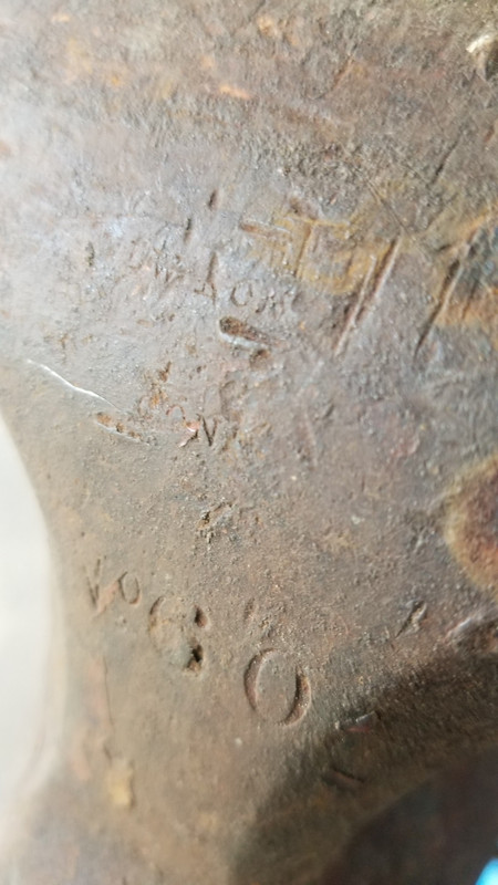

Today's entry attempts to follow the Hyde family. This entity is listed under many names, and is very difficult to follow:
Joseph Hyde & Sons
New London Vise Works
Hyde Vise Works
The first picture below is an advertisement from an 1838 Hartford, CT newspaper. The second picture is from the 1898 New London City Directory. The rest of the pics are from a recent ebay sale of a New London Vise works post leg vise.
New London, CT -
Link to an 1897 Receipt on Toolmera.com - This receipt notes that the proprietors are Joseph Hyde, Sons & Co.
See Image 1 Below where we find an advertisement from the 3/20/1838 edition of the Hartford Courant for Hyde & Sons Vices.
Based on the 1880 census, Joseph Hyde (age 54) is listed as a blacksmith, as is his son Joseph Jr. (age 31). However, Joseph Jr.'s brothers Joshua (age 29), Samuel (age 23) and George (age 14) are all listed as "Vice Makers." In the 1870 census Joseph, Joseph Jr. and Joshua are all listed as "Vice Makers."
Just when we think we've gotten somewhere, the records throw a curve. The 1884 City Directory for New London lists the following (typed below exactly as seen)
Joseph Hyde, vise maker, h Chappell
Joseph Hyde Jr., vise maker, rear of Woodbridge
Joseph Hyde Sr., vise maker, rear of Woodbridge
Joshua Hyde, vise maker, bds Chappell
Joshua Hyde, blacksmith, h Fort Neck
Joshua Hyde, vise maker, bds r Woodbridge
Samuel Hyde, vise maker, bds r Woodbridge
Samuel Hyde, galvanizer, bds 158 Bank
Samuel Hyde Jr., blacksmith, h Fort Neck
William H. Hyde, vise maker, bds Chappell
It would appear to us that we possibly have 3 distinct families/operations making vises in New London, all named Hyde, and mostly having the same names! The family records do seem to support this theory since we find numerous records but they all seem like they are different families/households.
In the 1892 New London City Directory the New London Vise Works is listed as makers of Ship Clamps.
In the 1905 New London City Directory, the following information can be found:
- Robert Chamberlain is listed as an Engineer at Joseph Hyde & Sons;
- Joseph Jr., Samuel and Joshua Hyde are listed as Proprietors of "N. L. Vise Works";
- New London Vise Works (J. Hyde & Sons) are listed as manufacturers of:
- Jack Screws
- Machinists & Machinery
- Vises
We find references to this company, albeit scarce, up to 1925. They appeared to specialize (in terms of vises) in exclusively Post Leg Vises.
Joseph Hyde's obituary confirms that, along with his father and brothers, he founded the company. Mr. Hyde passed away 5/25/1932 at the age of 81. He was an English immigrant.
We are looking into the question as to whether the vise patents of John Lee and Isaac C. Tate, or perhaps Sidney Hubbell were manufactured by this company.
Here is a price list from the December, 1890 edition of Iron Age. The Iron Age advertisement mentions Hyde's Patent Vise on multiple occasions. It's interesting to note the various styles of vises represented in this list. As far as I can tell, we've only ever had post vises come up as examples.
Here is another old advertisement for a foot operated blacksmith's vise.
We also found British Patent #1361, 5/14/1857 by William and Joshua Hyde, vice makers in Dudley, Worcester, England for "Improvements in the construction of vices."

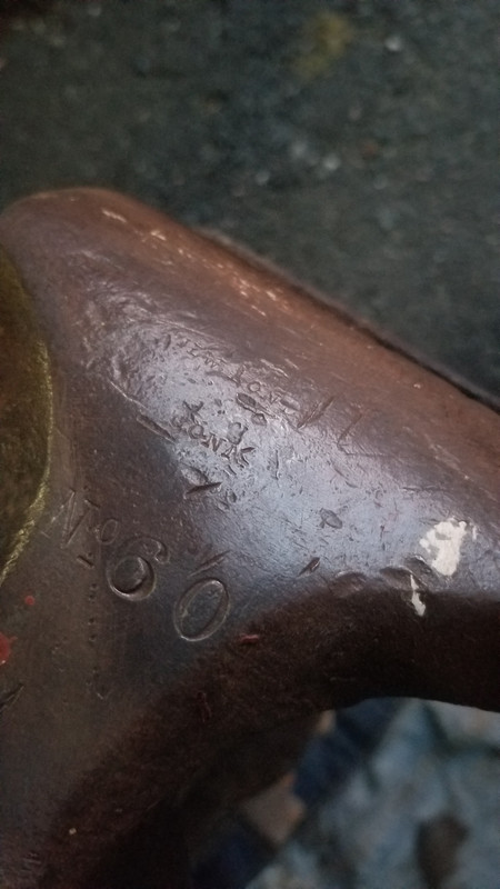

I happen to have recently brought home a NO 60
I hope to get the No 60 cleaned up and set up for use soon.
The spring is a little weak or worn but the screw lines up and the action is smooth

I have a hefty Post Vise I picked up in 2017, and until yesterday, I could only make out New York on one jaw, but since a previous owner painted it, could not make out much more. Last night I removed the paint and saw “Hyde” on the line above New York.
My searches for further info have led me nowhere. Can anyone provide any data or leads I can follow to possibly find out about where they were and when they made vises?
Cheers
Lee
13,532
Cheers
Lee
Maybe search this thread for "Hyde"

is9582
Jun 12, 2017
7
Thanks RTM. I did miss some of the “Hyde” info in page one; not sure how I glanced right over it. I’m wondering now if the family Hyde from CT had someone more ventilation NY, or if another Hyde. Very similar attributes comparing my vise to some in the photos.
@four.cycle thanks for the links. I’ll check them out! 👍
Lee
