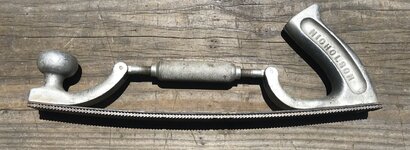

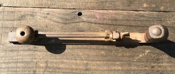

I have a "Vixen" style file with a metal holder with the turn buckle to allow bending the file. I bought both at Sears back in the mid 70's to do some body solder work on my model A Ford

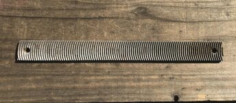

I have a bunch of Vixen files, some are marked Heller, some Vixen, some both. I sent them all to Boggs Tool in California for sharpening. I use them for woodworking, not autobody. They make a very quick, clean cut in hardwood and they are great for final shaping of curved surfaces and knocking off sharp edges.

I recently picked up a batch of old files in a homemade roll. There were a couple of Vixen files in the roll and I finished cleaning one up yesterday. That got me started on a Vixen file search and I discovered this old thread that Woody started a while back. IMG_2647.jpeg
Other Vixen file related tools.
