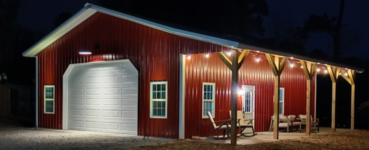

I mentioned some of the backstory in my introduction thread. The wait to get started is over, now we just wait for the finish!
This will be a 30x40 pole building with 12ft walls and an 8ft lean-to running the length of the right side. A single 10x16 residential style door will be flanked by a window on each side. The primary use will be automotive maintenance and associated tinkering.

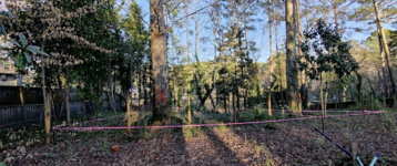

Here's the same location a year ago, only from a different angle. No small change!
I suspect there will be worthwhile updates on a weekly basis through the end of the year. I'll do my best to keep up with posting them.

Weather for the week had been more damp than hoped for, but the crew made up for lost time Tuesday and got the basic structure together by Wednesday evening.
Two sides had been covered by Thursday afternoon, then Friday morning a third side. Friday afternoon was a scramble to get the roof on as rain approached. They got it all up but only have a few screws tacking the last few panels on.
Still soaking it all in and getting used to it finally being there. The layout and relative position of our house means it can be seen from almost every room so I've been stopping throughout the day and staring out the window like a creeper... Haha.
We have been reviewing the interior layout of the shop and electrical plan now that we can walk through and gut check. Glad we did because we have almost completely reimagined it! The space claim for a future half bath has swapped ends and the primary work space with the 2-post move from left to right. This was one of the earlier layouts I had tried in CAD but ditched for one reason or another. In person it makes the most sense for my particular workflow.

I think I can now say we are nearing the end of the initial construction phase.
There is an insulated structure with (still curing) concrete.
All doors and windows are now in place so the building and what it contains can be secured. You may also notice that the gravel drive is in along with some mulch for erosion control. We are now done with the mud we have been dealing with for the last four months. The drive door is a CHI raised long-panel, vinyl backed insulated steel door with a jackshaft operator.
