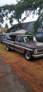

Also got the truck painted. It went from a brushed on coat of "poop" brown primer to my "custom" mix of 4 quarts flat black & 1 quart gloss black.20220621_210045 (1).jpg20220709_140707.jpg20220722_204649.jpg20220722_204839.jpg20220722_215541.jpg20220722_215625.jpg20220723_185844.jpg20220722_204934.jpg

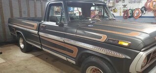

The old truck-a-saurus came out pretty nice. The trim on the sides is made out of thin diamond plate sheet cut into strips, bent length wise, and held on with double sided panel mounting tape. The paint gun is the cheapest hvlp unit from Harbor Freight. $16.00 with tax, A gallon of thinner to clean it with is $20. The ONLY problem I had was I read the directions on the paint cans and followed them. Rustoleum says to use acetone to thin it with. I normally use mineral spirits or enamel reducer in it. In 80 degree weather, the acetone flashes away right out of the gun. So... the actual paint goes on thicker and doesn't have time to flow out and get smooth like it should. In a couple spots it looks kind of bed-liner-ish. But, over all, I'm happy with it. It's a good base layer for some graphics and pinstripes come next spring. Besides, it's a truck I take to the dump for crying out loud.:lol::lol:

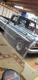

20240520_174153.jpg Here's how the truck looked for awhile.
20240525_162809.jpg Then I got a bored and went a little nuts.
20240602_125019.jpg I think it came out pretty good.
20240604_192533.jpg Here's a pic outside. One of my buddies has been working on painting his show truck for the last two years. Still not done, so we end up taking my truck to the big annual event at the fairgrounds this year. No trophy or anything, but, I did get a lot of compliments from owners of other "bump-side" f100's.

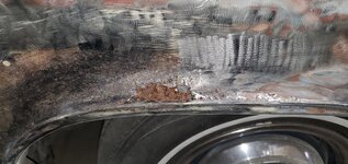

One of my coworkers and I went to a car show this last summer in my 1965 Buick Skylark. He's another old car guy like me so hewas asking all about "Buford". I was bragging about how solid the body is...until I went to show him the trunk floor20230924_134710.jpg This is the "sunny beach" that started this journey.
20241211_191455 (1).jpg Then there was the rust repair on the windshield frame.

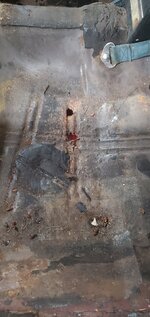

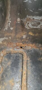

20230924_134555.jpg After further inspection, there was MORE rust. 20240820_191407.jpg 20240726_191546.jpg 20250111_164912.jpg 20230924_134710.jpg LOTS more rust! Front window frame, rear window frame, BOTH front fenders, some really old body work hiding...{wait for it...} MORE RUST!!!!! I'm going to ignore the doors for now, but, they are getting "the treatment" as well.
After all this rust killing and repairing, I do have some plans for fresh paint, a bunch of new weather stripping, and some other annoying little things I've been putting off fixing.
