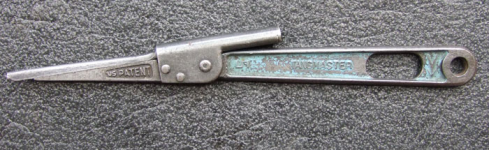

What is it?
It is a hammerless drift remover for removing chucks or drills. Where we would normally use a struck wedge style this thing rotates eccentrically to push the center wedge out to pop the chuck out of the sleeve. Using this doesn't risk damaging the spindle bearings from you whacking on them sideways.
So you put it in with the handle up then rotate the handle down, the wedge comes forward and the chuck pops out.

-A somewhat uncommon item. I've only seen/used about a half dozen in 35+ years of working in machine shops. Sometimes they work, sometimes they don't. Still a nice item to have, you'll find a taper or sleeve it works on.

I posted this Tangmaster version of the same type of tool in September last year in the "Share unique tools others may not know about" thread.
There are similar tools still made by German manufacturers.
I thin these are less common than basic drift keys due to the way higher cost.
