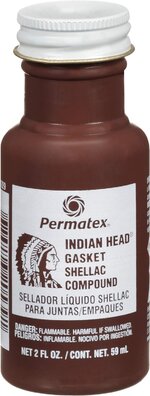

No RTV unless you want to fight getting
it apart again.
For intimate matched cases (no gasket)
there are a few things you can use.
If you want to take them apart again
you can use Hylomar sealant. It is
expensive and hard to find in the US,
so Permatex #2 or Avaition Permatex
(also called Gasgasinch) is also good.
These you can take apart easily.
For something you can still take apart
but it requires a jarring loose with a hammer,
just use regular old Indian Head shellac
type sealer. This was the original
Permatex formula devised for patching
tires. You know, Permanent Textile repair
(for tires).
