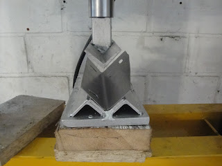

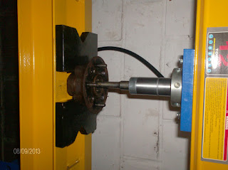

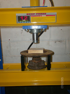

I bought a while back a 12T press, Once you have it it's a great tool!
So far i have build a small bend tool:
Used it to split ball joints!
Press bearings out:
And lot's off stuff:
I do like the pressure gauge & side pump.
Great shop tool!
