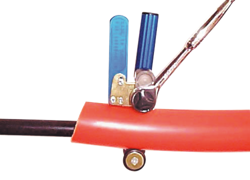

I wonder if that would work on PVC inner duct.
Exactly what i was thinking.. i have one that uses a ratchet or drill with a square anvil adapter bit that works really good though.
Theres a router bit available for palm routers that can be used too. Both work good for smooth wall. I bet that utility blade on an OMT would tear right trough corrugated, i dunno about thicker smooth wall.
decableguy2000
Nov 4, 2012
651
The one I use, works well but manual only, like an old can opener.
Yup.. those are on every truck.. that ratchet one was another tool i bribed my vendor for.. the innerduct cutters i use are just from HF. They work great and are only like $7.. i have Milwaukee’s that should be coming at some point in my life..
