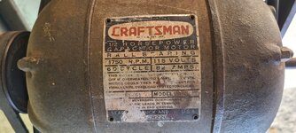

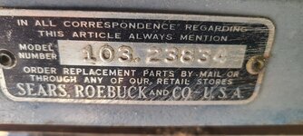

I have had this kicking around a while and just wonder if it's worth more than a typical garage sale $50 table saw. Can't find a date on it. Works fine. Don't know what all is original on it. Thanks for any info!

IMO, based on the condition, it's not worth $50. But, prices vary by region.
The tilt gears on those 8" saw are often fubar.
Table saw motors are generally 3450 rpm. date code on the motor is June 1951.

The stand is also a Craftsman product, likely original to the saw. FrankLee is probably right as far as $$ for a potential restoration. However, those old Craftsman saws are a step up from a lot of the current plastic saws. A similar Dewalt with stand sells for $350 on sale today at HD. I'd happily pay $50-75 for it as a job site saw to insulate my cellar or redo a room. $100 in good condition with all the parts and stand, as yours appears to be.

Those are tough little saws, and you have fence, miter gauge, and stand. Motor too, but I agree with Frank Lee that it seems like a mismatch in terms of RPM. Good motor though. No table extensions, apparently. I would think that, sadly, $50 is about what you'd get around here, unless you get lucky and find the right person.
