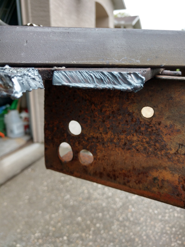

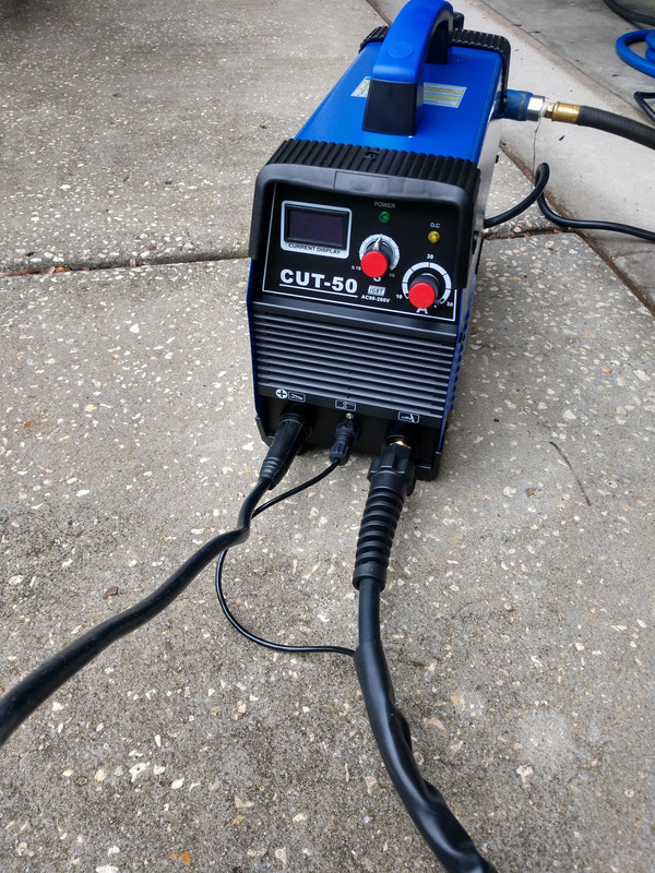

i just bought one, got it yesterday. wanted something to play with, never used one before. paid $199 off amazon. this is my first try cutting, 1/4". non pilot arc. seems to work ok. i'm sure the cuts will get better once i learn how to use it.

looks like you need to move slower - you want a little more vertical in your cut lines, less angle. are you holding the torch mostly perpendicular?
in my post above i was using my left hand to help "inch" my right hand along the straight edge. I found that you can hear "turbulence" in the plasma jet if you're moving too fast - it might take a bit to be able to hear that, and any spray-back at you is also a sign to slow down.
cutting 3/4" you find out REAL fast the difference between "just right" and "gobs of hot metal blasting your torch hand".

thanks for the tips :beer: i'm sure i had the torch at an angle.

if you hold the torch at too much angle, you're effectively cutting thicker metal, which doesn't help you out.
