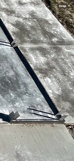

Wish i had better pictures. Here is mine with a similar bracket system.

Is that concrete pier systems? I’m not sure if it is.

Thanks for providing a link. Your brackets are similar but they are a different brand. I’ll look to see if they provide structural reports on their brackets
