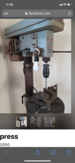

Good day
I wouldn’t say I’m in the market for a drill press but I don’t have one and can see the benefits of having one. Anyway I was on the Facebooks and seen some decent deals just wanted to see what the experts thought before I tried to grab one of these DP’s. The use would be limited but I also like quality tools. If I drill a hole with it I want it to be straight ect.
There’s is a Jet 5 speed 1/3 HP for $75
And a American Machine Tool 12 speed for $150
I like that the AMT has a crank to adjust the table though I’m not sure it’s required for my use.
Any thoughts would be appreciated

Those early Taiwan machines were good. Table lift, 3 pulley/wide speed range, usually decent TEFC motors, table lift/rotate, decent build, etc. Those prices are decent. There were a gazillion different brands but I suspect they all came from the same factory and were almost identical. It's personal preference whether to go bench top of floor but I'd go floor any day. Benchtop real estate is more precious then floor space IMO but YMMV. Floor DP's are also more versatile.

I always like those Taiwanese presses with the 2 switches for light and motor. The keyless chuck is also a nice upgrade. Definitely worth $75

The AMT, as Davefr has pointed out, is Taiwanese. Dating from early to mid ‘80’s if memory serves, and no, not bad at all. Not the same quality as a British or U.S. made drill, but one of Taiwans first attempts to get into the pro market.
Yes, same machine can be found with many different names on, the only major variation seems to be the column height and the table. I own one of these, had it from new, and it hasn’t been bad. There is a version with plastic parts (the collars that position the rack on the column) that I’d avoid, but most others are o.k.
Only weak point is the original Taiwanese chuck. Not the best, and struggle to hold anything much below 1/8”, but not a problem here with the keyless. If that's a German made chuck it’s probably worth $50 on it’s own.
That’s the machine I’d go for.
And you will use it more than you think. With a rigid table and constant downforce you can drill things that you wouldn’t be able to by hand, and everything you drill is square about both axes, and to depth. I have other drills now, but I keep the Taiwanese one almost exclusively for woodworking, and it’s worth it just for that!

Also think about what materials you might drill through... and what speeds that will require. If you want to put a decent size hole in a piece of steel, that 5-speed press may not run slow enough. The 12 speed should run slow enough.
I have a HF bench version similar to the 12-speed (mine's old enough to also be Taiwanese made), it's not the most precise but it works well.

It's a Delta DP225 if you want to research it. I've owned a few of them and they are nice lighter-duty machines. The speed range is more optimized for wood working, but it will also drill up to around 3/8" holes in steel. The Taiwanese DP has a much larger column and more heavy duty, plus it will accept Morse Taper bits and chucks.
