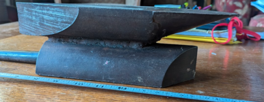

Thoughts on this Anvil

It's from hobbyist's estate sale. Jewelry, lampworking, copper etching, paper press. Pulled 80 lbs of copper plate and 7 oz of sterling silver from this lot.
I can't quite figure out what you would do with such a horn. I think it's reversible, which gives all these acute angles. Probably, for shaping copper forms, but like what. A can, a bracelet, a box?​

The horn may be for ring sizing.
Basically, you put the ring on the slight taper, and hit it with a rawhide mallet down the taper to stretch the ring larger.

Below is a photo of something called a blowhorn stake from another GJ member. The narrower horn pointing up in the pic is used for ring and tight curve shapes. The larger horn is for cylindrical forming.
