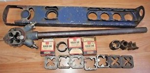

I'd like to be able to cut and thread 1 1/2" galvanized pipe on an occasional basis. This will be used pipe, so free threading from the big box stores is not an option. It will not be used for plumbing... just bars and railings.
It would be nice to have this threading capability on an ongoing basis, so I'm looking at used threading equipment options. I need some guidance on what the options are, and if 1.5" is too big for hand operated thread cutters.
Most dies I see stop at 1", including the manual thread cutter I already have.
Ideas?

Around here, good used Rigid manual pipe threaders are cheap on CL. You could buy a whole set for $150 but of course you only need one. They have a couple of formats but they generally go up to 2". You can also get a power threader from HF for $179.

You can easily thread up to 2" by hand. A machine or pony threader makes it a whole lot easier, but sure ain't required. Rigid is the most well known name but don't hesitate if you come across rothenburger, they make excellent equipment. My small power threader up to 2" was an RB and in its day cut thousands of threads and never had an issue. I'd suggest you surf Zoro's site for a handle and die and wait for a 25 off day.

The Ridgid 535 is the gold standard imo up to 2" pipe. It is quite expensive to buy, but you can thread all day long. I believe Ridgid also has a hand-held threader which spins the die(s) and you simply feed it into the clamped part. Not sure on capacities there.
I think Oster is also a competitor but I can't comment directly on their machine having never touched one.
I've threaded some 3/4" by hand, its a pain. The dark threading oil (same as goes in the Ridgid) is preferred lubricant. I wouldn't want to do many 1-1/2" by hand. It will need extremely long handles, possibly a helper, and a pipe vise that can resist the torque.

Craig's list, rigid hand threader, tri stand vise. Piece of cake. 1.5 inch pipe is easily threaded by hand, takes awhile if doing a lot but no need for power threader unless you are doing it all the time. I'd say a tri stand vise is more important than a power threader. Lots of cutting oil when threading is crucial also

I have hand Ridgid to 2” and power driven Ridgid 2 1/2” to 4” and HF to 2”. ( I’m old and can’t recall the Ridgid numbers right now) When threading under 2”, I use the HF. It’s lighter, quicker, and cuts good threads. Amazing tool for the money.

I'm a little blown away at the can't be done crowd.
You can cut them with a Ridgid 65R, which is literally designed for hand threading 1-2" pipe. They are regularly on Craigslist for $100. In contrast with the smaller fixed die sets, there are fewer cutting edges in contact with the pipe to make hand cutting possible, the fine folks at Ridgid already though of that for us.
What should be noted, is that pipe holding and oil are super important. You'll need a good pipe vise. Walrus pointed that out.

Hand threading inch and a half isn't bad,
just cut the pipe straight,
have a good vice,
a nice oiler
1ED22_AS01
and back up the die once in a while to clear the cutting teeth.
Speaking of teeth,
push down on the threader, never pull it towards your face :scared:

A old Ridgid 400 pipe machine can be had by me for $200.00 with old key chuck. The 400 speed chuck is closer to $500.00.
The 65 R is the easiest to use to thread by hand. You set for 1 1/2" and the adjustment has a locking screw. Face up threads against pipe and tighten rear screw. As you thread it draws dies onto pipe. No pushing force required as with a drop head set.
As for a pipe vise, get a RIDGID CHAIN VISE TRIPOD. It has many uses over a yoke style. You can even hold logs or lumber in it. Amazing tool with many uses. The chain will even hold odd shapes and fittings too.
As for a pipe cutter, a RIDGID 1 to 2 WIDE ROLLER would be best. Their standard is fine but for hand use the wider rollers will help prevent tracking.
