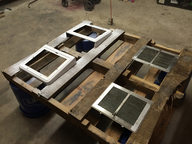

Painting Heater Vent Covers

JMURiz
Dec 6, 2005
1,483
NoVA
Cool project!
What'd you use to get the old paint off the vents before painting?
I've been trying to figure out how to attack mine (1940 house with tons of paint layers)

Cool project!
It was a lot of work. We stripped down 2 vents in our living room and they look amazing with new white appliance epoxy spray paint. To strip we used a Rust-Oleum gel stripper. For the quality hands down the best way to go. For amount of labor not so much. For the bathroom vent that is hidden behind the door I just added another layer of paint (well appliance epoxy). It looks okay, but it's not all smooth and shiny like the ones that received a full on restoration.
May I also suggest stripping the outer cover and then not stripping the vent portion. It's the little fins that are difficult to clean between. Any mostly flat surfaces will quickly strip paint off with that Rust-Oleum product. My wife has also used it on an old wooden dresser.
