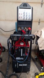

For the Money the AHP AlphaTIG 200X is a GREAT buy and works well couple mild upgrade parts, the $99 NOVA pedal, and a better Torch and lead... I added a Cooler and 20 Torch to my personal one as well. It acts like a MUCH more expensive machine, the MILLER Diversion is a decent machine but at almost 4x the cost. the Miller 210 is not a great machine and is Synchrowave in name only, IIRC it is an inverter in a big box. not a Transformer machine like the Synch should be.

The AHP is an awesome machine, for the same money as the SW200 I have a 200A 60% Duty Cycle, 150A 100% Duty Cycle Water cooled machine, with pulse up to 200PPS, frequency control up to 200Hz down to 40Hz I think, Post Flow up to 10Seconds etc etc etc. The Machine works nice for the money... Noticed also the SW200 has a regulator not a Flowmeter.

I love my AHP! That's a nice cart setup, by the way. Homemade I assume? I've been thinking about doing a very similar setup with my HF MIG on the bottom.
