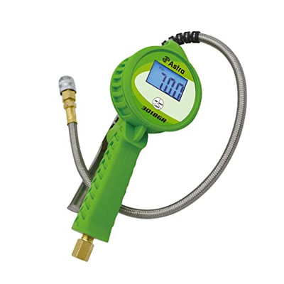

For accuracy under $50, digital is the way to go. I have an inflater gauge combo that works great.
