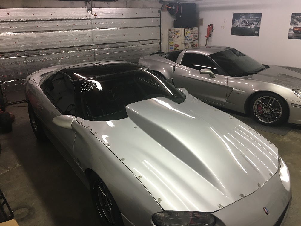

I'm **** so I use 3x3 carpet squares. Flat spotting is usually only an issue with bias ply tires but I still do it on radials. The Z06 sat a lot so I always had it parked on the squares as you can see in this photo.
Procedure for storing that car when it may sit for a year was: wash and detail it, fill it up with fresh fuel and some stabil fuel additive, check tire pressures, park it on the carpet squares, put the battery tender on it an lastly turn the garage furnace on 55 and then forget about the car till I'm ready. When I pull it back out I would change the oil first before driving. I was just very picky with that car.
