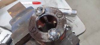

The Cobbler
Oct 24, 2013
26,302
started cleaning the dies up today . also bought a 1/8 & 3/8 off an ebay seller, they are in transit
some of the cap screws were really tough getting them to budge.
hand impact worked on a few , but there were 4 really stuck. cleaned them up and welded some washers on them. the rust was no fight with vice grips turning the screws.
here they are with all of the cap screws loose or removed . not sure how far to go with these, after all this is GJ, but they are just tools too!

BreeStephany
May 19, 2012
871
Oregon
You've already got far enough to take them apart... put them in evaporust or an electrolysis bath, wire wheel the bare metal parts, media blast or chemically remove the paint, clean them with a good solvent to get the years of threading oil out of the metal and put some nice paint on them.
If any of the dies are messed up, look for replacement NOS dies on Ebay.
They will be good as new!
