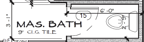

The inner webs tell me I’ve got to place my toilet a minimum of 15 inches from the finished side wall. The sources I look at make a point to emphasize this.
I can do 14 inches or I can do 24 inches to avoid the joists under the floor. I’ve mocked it up at 14 inches.
While it’s tight, I think I can live with it. I’m out in the country and this is a cabin so code is not an issue.
I could use the saved space. But I don’t want to do something stupid.
You guys seem to know this stuff. What do you think?
Thanks
30" is 30" if need to start moving floor joists to move it an inch and it's not being inspected,I wouldn't worry about it myself.

My master bath is 14.5" and I have never experienced a problem and could easily give up the extra .5". My old house had a half bath off the master bedroom that was even tighter. The only time I had an issue there was when my Mom's jade necklace went down the toilet and I had to pull the toilet to retrieve - it was a pain to pull the toilet and get it past the sink that protruded into the area in front of the toilet.

Can you change the offending wall? Move it or change it to flat framed? Changing a 2x4 wall to flat framed you pick up 2”.
Walls get flexible and don't have the depth for an electrical box when you do that. 2x3 can be made to work in some cases though.

Yes they can get flexible when flat framed. They do make electric boxes that work for these situations though.
OP has 1-1/8” subfloor. Then let’s assume he has ceramic or hardwood with a typical build of about 3/4”. So he has 1-7/8” from bottom of toilet flange to top of LVL joist. An offset flange will work here.

I'd suggest going more than 15" rather than less, just from experience.
Yikes, I'd hate using that toilet. I would hit my elbow on the vanity every single time.

I think this came out pretty good all things considered. Just fits the offset flange. Gives me a solid 16 inches from the wall.
The CD trick worked great. Used a keyhole saw on the lvl for more control.
