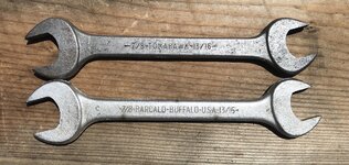

Late to the party (per usual) but happy to re-post the comparison image here for continuity.
Could be that Barcalo was making the Tomahawk wrenches on contract for Walden. :dunno:

Thanks for the photos! This has me leaning heavily into the barcalo camp! The barcalo has the same kind of font as the OP wrench too.
Sometimes it just requires having access to looking at LOTS and LOTS and LOTS of wrenches for comparison.
You were late "in person" only, here in spirit and linkage. :) I referenced your comparative analysis on Don's thread by name in my first post upthread, a photo of your whole set of Tomahawk wrenches appears in the second post in that referenced thread, your comparison photos appear on page 2 - following what is probably a red herring dialogue about the asterisk forge mark typically attributed to Vlchek, and Don provided the link. It was a click away. :)
Perhaps. Regardless of the OEM, as of right now, there is no evidence that shows Walden using the term on DOE wrenches. As I summarized in my first post, the only Walden tools it appears on are primitive non-detachable type 3-way socket wrenches and a midget hex set, that apparently came in a metal case with a lid and an open clip in type holder. Bonney also used the name. And there is precedence for these anomalies (e.g., Wizard).

I think that the A1 forging mark doesn’t make them less likely to have been made by Barcalo. The dashes on both sides of the size markings looks very Barcalo-like and they used a large variety of different forging marks on wrenches including letters, numbers and asterisks. Probably made under contract for Walden.
-Don5E6DBC67-5941-4858-879F-6F0B9AB03A02.jpg93F5ECE3-7187-4561-8153-E056DFB22F51.jpgA0D2D5E1-7412-437C-AE36-579AC5B09AA1.jpg

16,766
The Tomahawk 7/8” x 13/16” DOE wrench came out of the evaporust today and after I cleaned it up I did a comparison with the same size Barcalo DOE. Although the Barcalo is finished a little better, they obviously came out of the same factory. The first example has very similar font. FullSizeRender.jpegFullSizeRender.jpegFullSizeRender.jpeg
