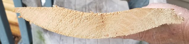

9710becky
Apr 21, 2017
1
Hi,
Could you please tell me the name of this style?
I have attached 2 photos.
It is 11/4 - 1 1/2" thick, when I measure the top it measures 7 1/4" - 7 1/2" and it comes in lengths up to 16'.
This was some leftover from a job and we can't find out the style or where to purchase it.
I do know that it is pine.
Thank You,
Becky
