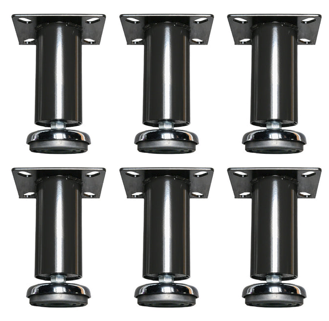

I don't have a welder and am not really looking to change that right now.
I'd like to get some height adjustable feet for a Matco tool chest that I just bought. Any recommendations on ones that I can purchase?
The bolt pattern for the casters is 4-1/2 x 4-1/8 and I need 6. I'd love them to go down to about 4" and need less than an inch of adjustability.
This is the kind of thing I'm hoping for, just need the right plate dimensions

Buy the closest you can and adjust the holes.A Dremel or round file would make short work of it.The legs will never be in tension or shear as opposed to the wheels you’re replacing.

I can't fid anything even close. They all have much smaller plates

Can you buy some steel plate, cut and drill to fit and have them welded to the smaller plates. A local welder wouldn't charge much as a simple stick welder can do four 1/2" tacks per plate. OTOH, this is maybe the easiest welding ever so a good time to buy a cheap welder and practice. No one will ever see the results.

Certainly possible, although at that point, I'd probably just cut the plates off and replace them, but I think at that point, a scratch build would make more sense
I'm really not setup for metalworking at all. I'd have to buy the plates precut (including drill holes).

Hacksaw, drill, and some steel plate from the hardware store. It’ll be ugly, but it’ll be hiding under a heavy box you’ll never look under again.

Send cut send should be able to help with the plates, then just find a shop or someone with a welder to make some tacks.

Absolutely. It's about $25 a piece for them.
When I add in large coupling nuts and feet, I'm at about $35 more, or I buy the prefab legs for about the same, then welding. It'll be $600+ once I drop them off at a shop

You probably could get away with some 6 x 6 x 3/16 plate, drill it for your bolt pattern & cut a hole in the center to slip over the adjuster. Bolt it up & should hold it secure, could even step up to 1/4" plate, either way cheap & easy.

Could you buy feet that are close and them bolt them to an adapter plate that bolts to the toolbox? No welding involved, but you would have to drill holes in steel plate. You might be able to get some remnants from a welder or metal shop. Do you have any ability to cut metal plate? If you use aluminum, you can buy a non-ferrous material blade for a table saw and cut it. Aluminum drills relatively easy as well.

Harbor freight sells a set of adjustable height feet for their Icon cabinets. They have multiple slotted hole patterns on them already. Unfortunately they do not list dimensions on their website, but you might be able to look at them in a store before buying them.
$100 for a set of four.
Could also call Matco and see if they sell a set.

I looked at those, but a review noted how small the plates are

I decided that I'm going to try 3d printing some feet. I think I know where the box will live, so I can actually do custom lengths to level it out.
With the right wall count and infill, it will be way more than strong enough.
A really quick model spit about 500grams each so even with a fancy carbon or glass reinforced filament, its about $15 each

Posting here in case this comes up in a search.
First one is done
Filament is Siraya PET-CF. 50% infill, 6 walls, 6 top and bottom layers and I added features to make it solid between the bottom of the coupling nut and the tool chest. I think these are ridiculously overbuilt.
Grade 5 1/2-13 coupling nuts, swivel leveling mounts, and 5/16-18 serrated flange bolts, all from McMaster. The mounts are rated to 3750 lb each and have a 2" stud.
Min height will be right about 4", I'd say max would be 5". That could easily be increased or decreased with adjusting the printed part or stud length.
The McMaster order was $141 and 2kg of filament was $63.
Posted on Printables: https://www.printables.com/model/1665292-adjustable-foot-for-matco-tool-chest
