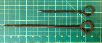

This is for fabbing/welding. I bought one of those tungsten carbide scribe tools that look like a pen but the tip kept slipping out until it eventually got lost.
I need another tool to do this job and am open to repurposing another tool to do it. Just need suggestions.

A simple blacksmiths scribe can be quickly made by taking any piece of hard steel, heating to red and quenching in water to harden it. Some steels require an oil quench or just air (leave to cool at room temp). so if you have an unknown type of steel you may need to try different quenches. Once a file can't touch it you're good.
Not diamond or carbide but easy and quick to make with whats on hand. Great for regular hot/cold rolled. Springs can be heated and straightened and are great for this. Valve springs etc.
Is S2 tool steel good for this application? I've got some drill bits made of this that I can sharpen up on the belt sander.
S2 should be great but it has a fairly low tempering range so don't get it too hot on the belt sander. keep dipping it in water when grinding.
-S-2 is more for shock applications like a chisel but if that's what's handy then by all means use it. You'll need to sharpen it a bit more often than a D-2, A-2, carbide type but S-2 will serve you well.
