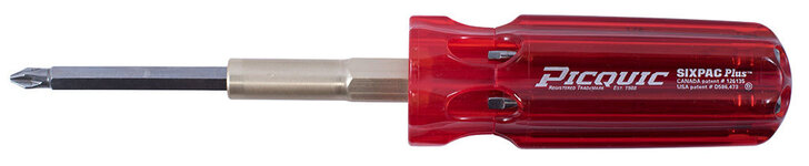

If you need a good multi-bit screwdriver for full-sized tasks, I'd probably choose a Picquic - again, to keep quality high and price low.
Six-pack plus maybe?
