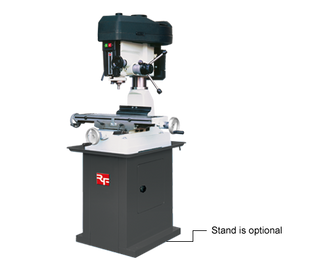

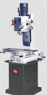

Just as a reference:
This Rong Fu model RF-45 is 726 lbs.
This Rong Fu model R-31 is 660 lbs.
