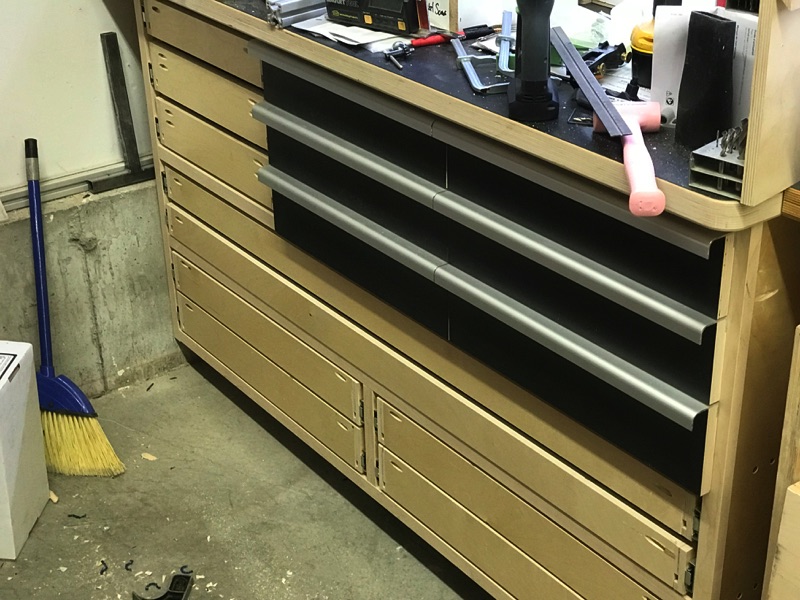

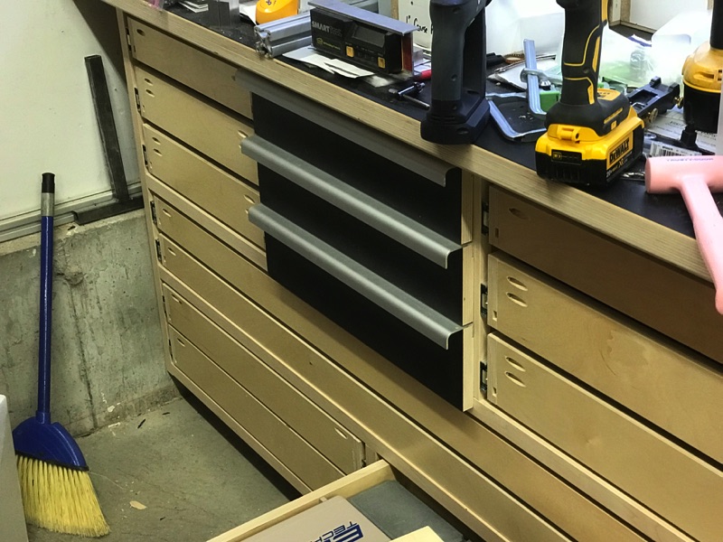

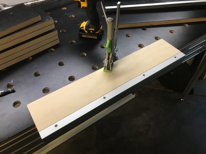

Beginning Drawer Front Fabrication

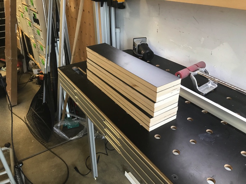

One of my goals for 2018 was to complete the fabrication of the chests/drawer bases. Other than organizing the individual drawers by adding dividers, all that’s left is to make just a few drawer fronts. The last set of bases had drawer fronts that I sprayed with poly and the process of doing so took forever. Each front took 3 coats front and back and there was about 36 drawers and doors. All in all, I think I sprayed nearly 5 gallons fo poly. Having to wait between coats is what killed me, given my primitive drying space limitations and the need for the shop to be open so the air could circulate, I could only spray ~12 on one side per spray session. As a result, I think I was spraying constantly for nearly 3 months.

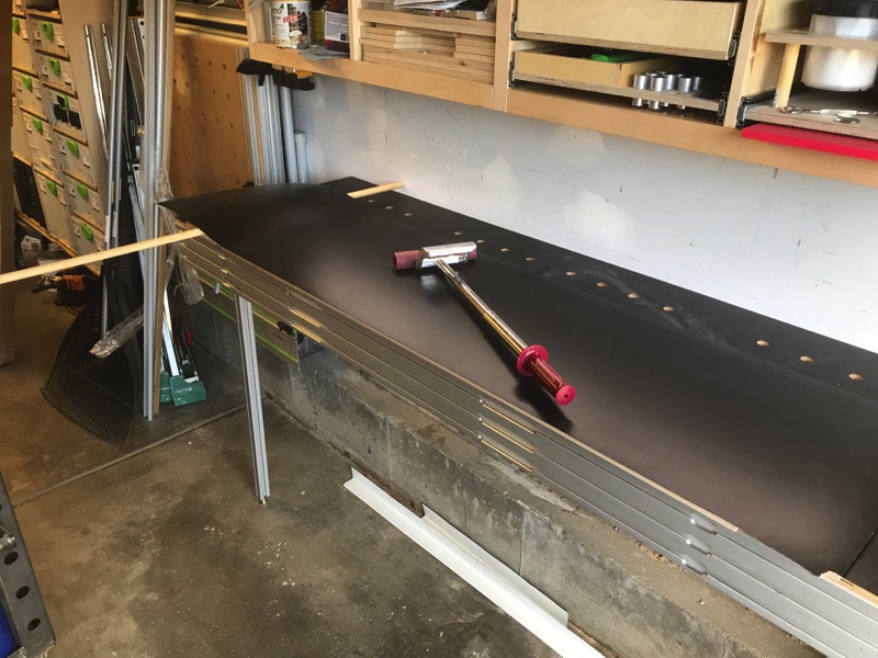

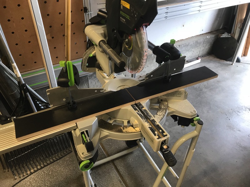

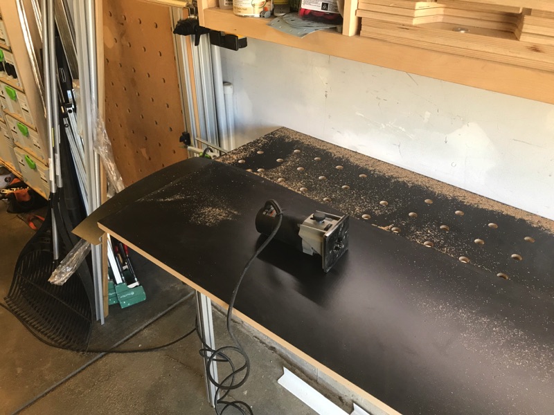

The weather just isn’t warm enough to spray so I needed another approach and I wanted one that was much easier than the last one. I have about 1 sheet of left over laminate so I thought I’d try laminated drawer fronts this time. The laminate is many times more durable than poly and much easier to replace and match in the future. This go-round I did myself a favor intentionally and made as many drawers the same size as possible. This allows me to go into batch mode on the fronts. To waste as little laminate as possible, I decide to laminate a large piece of ply and then cut it down into the individual drawers instead of pre-cutting out the drawers and then laminating each individually.
Even with he weather bing about 45 outside I’m still able to move fairly quickly. Setup time for the contact adhesive may take twice as long but, when doing multiple panels at once, I’m able to bounce around and keep progress consistent.

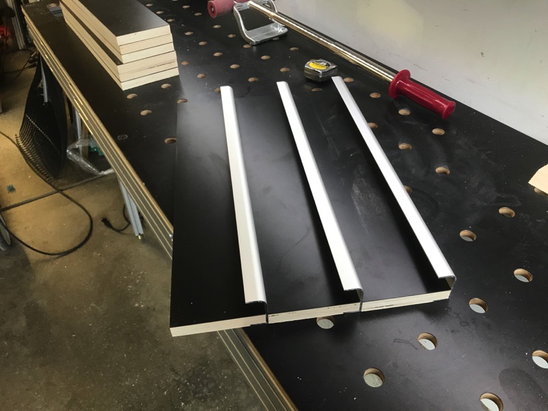

Quickly trim the edges and run a file around the perimeter so the sharp laminate edges don’t cut my hands up while feeding it through the table saw. Hate laminate trimming. It's makes a much bigger mess than just routing and the chips are heavy enough they go everywhere.
Once in strips, I then set the stop and whack up the lengths into the 9 drawers for the upper part of the tooling base.
Yeah, so MUCH faster than spraying.

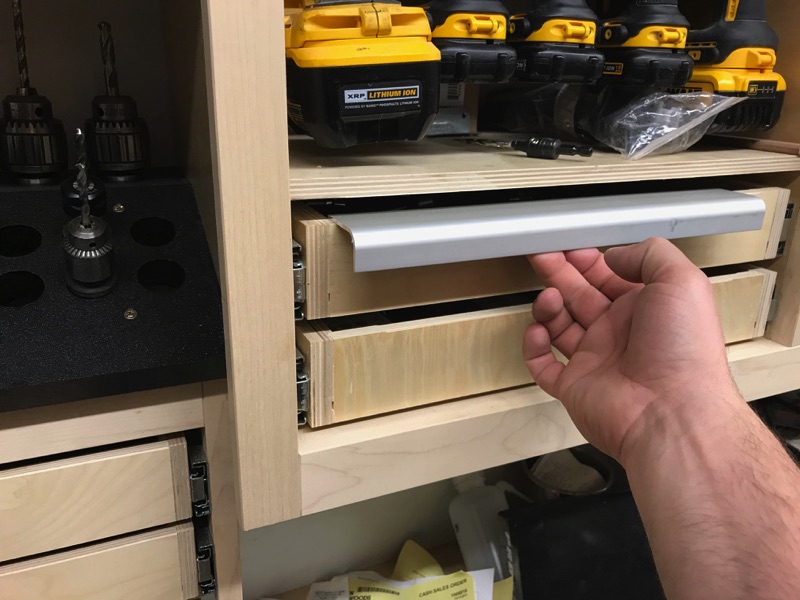

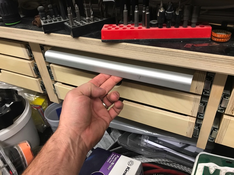

Now for the drawer pulls. I've spent months looking for exactly what I wanted. As a reminder, I'm building these bases as an alternative to buying expensive tool cart boxes/bases instead but, I still want the tool cart box/base look and function. Part of the look I find desirable is the large aluminum drawer pulls on the mac tool boxes.
After searching I fount it wasn't exactly easy to find in a comparable design which was also affordable. As luck would have it, I did manage to find 6-foot long extrusions on the ahturf.com website in a variety of profiles. These too are designed to be recessed/non-protruding drawer handles like in the picture below.
(ref bill steele @ lumberjocks)

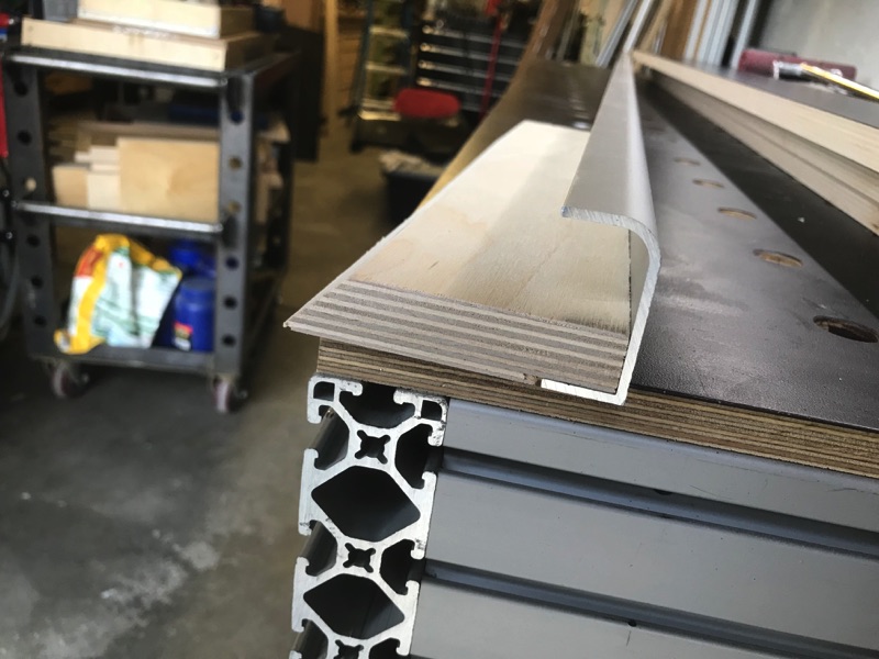

They have a few different styles available in the 6-foot length. I like them but I can't use this design because some of my drawer fronts on the smaller drawers aren't any taller than 2 1/2 inches which would make the pull more than half of that..won't work.
These styles attach to the back of the drawer front but stick out more like the tool boxes which left these profiles to choose from.

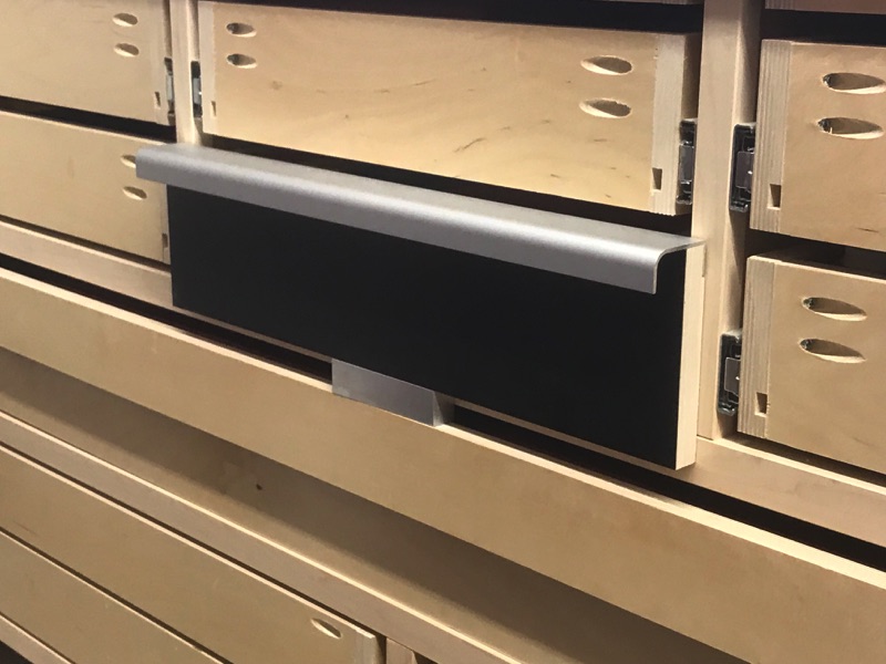

I went with the slightly more rounded look and ordered three 6-foot lengths. Here's the profile mocked up on a test piece of ply. Each drawer will need a slight relief cut in the back of the drawer so the pull sits flush.
With the saw dialed in, I back cut 3 of the drawer fronts for a dry fit. I like the look. I’ll have to figure out if I need to paint the sides of the drawers or if I can use a natural finish on them. Think I’ll have to see it all come together before I’ll be able to get the full effect but a quick mock-up reveals it's going to work.

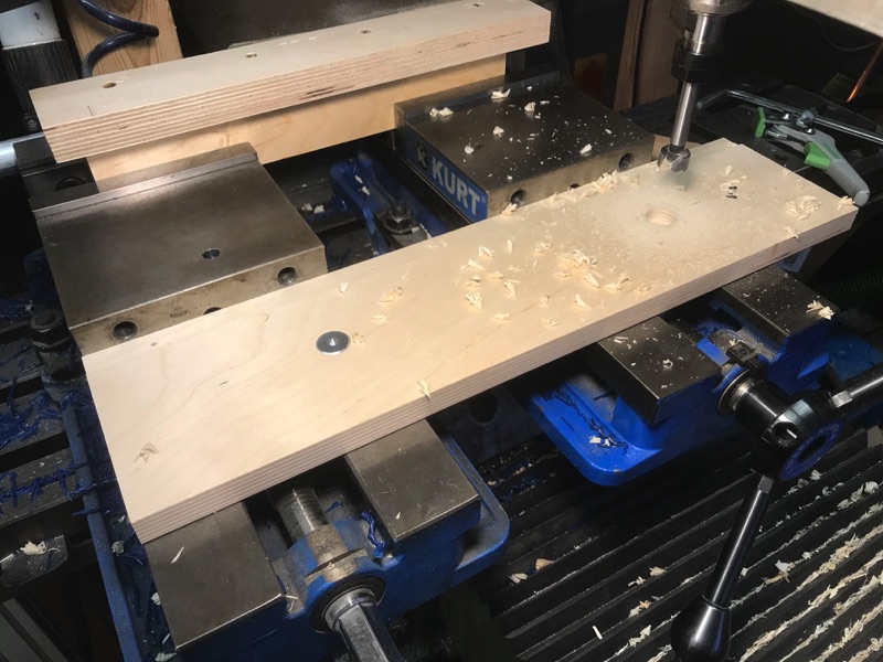

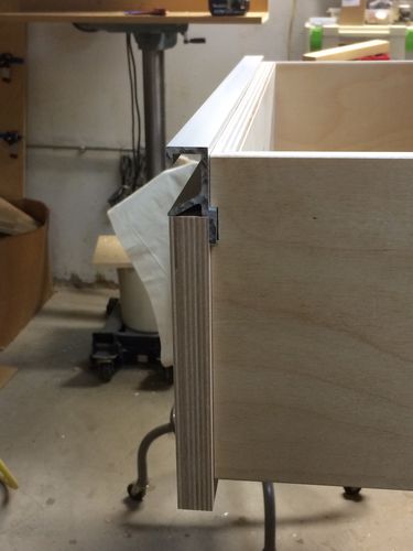

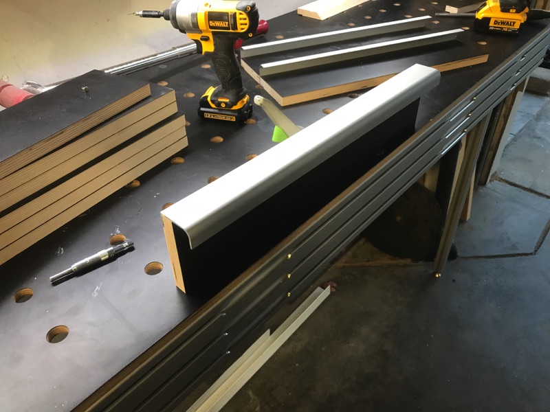

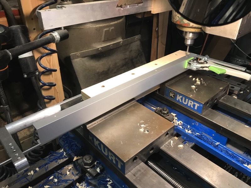

I made a quick fixture and programmed the mill to spot drilled the back of the extrusion so I could get all of them spaced consistently. Quickly I learned that it was far faster to hand counter sink the holes than switch tools on the mill.
Last op is to machine the pockets for the Blum drawer front adjusters. There is no easier way I’ve found to get drawer fronts attached and aligned quickly and accurately.
4 screws and the pull is securely attached.
Finished drawer front. A subtle semblance of a mechanics tool box.

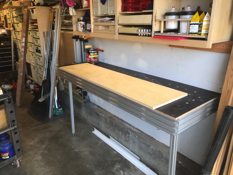

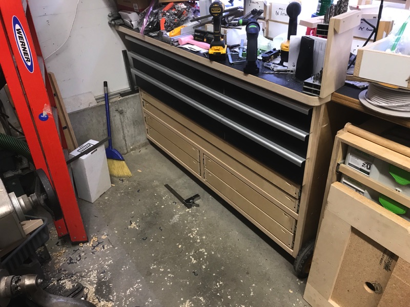

I found a piece of scrap aluminum that was the perfect spacer for mocking up the drawer. I typically start at the bottom and work my way up. This allows me to use the lower front and a spacer to get the alignment right as I work my way up the cabinet.
Each New drawer front rests on a spacer, and then I use a square on either side to make sure I have it aligned correctly with the one below. Repeat the process all the way to the top.
Move over, set the next base and work my way up.
Until I’ve completed the cabinet. 9 gives a much clearer view of what it’s going to look like when it’s done. It’s better than I had hoped and the slightly rounded leading edge of the pulls looks ultra clean and gives a nice feeling to the fingers when pulling the drawer out.
I’m a little disappointed I chose the conservative route and only ordered 3 of the pull extrusions. Now that I get to a point where I’ve got the machines setup and the process down, I’m out. I grabbed one of the drops and walked around to the rest of the drawers to see if there’s a way I can utilize them. I had originally planned on having full length pulls on the bench over drawers as well.
The overhang isn’t deep enough to have the same reveal as the lower bases which I could deal with 2 different ways-
1. I could remake the top to be wider
2. I could mount the pull differently. Instead of mounting the pull the the drawer front, I can mount it to the inside of the drawer itself effectively setting it back 1/2-inch. If I do that I’ll need use thinner material for the drawer front, maybe 3/8-inch instead of 3/4-inch, to give enough room for my fingers to get a positive pull.
On the smaller utility drawers the pulls would work just fine and I might be able to get away with using smaller sections and not running the full length of the drawer. I’m thinking that 6” pulls on these drawers would suffice.
I walked through and did the math - looks like I’ll need 18 more 6-foot lengths to finish both bases/benches. Ouch.
