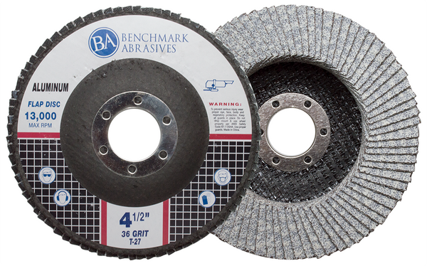

I think a 4-1/2" grinder is going to be your friend here. I don't own a 4-1/2" with a guard on it so your results may differ.
I just bought these flap wheels specifically for aluminum and they work extremely well.
