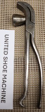

The following seven pictures show different lasting pinchers (pliers). The first group is from R. Timmins & Sons of London and there are the sizes of #5, 4, 3, 2, 1, 0, and 000. Timmons was bought out by Wynn & Co. about 1887. The #4 is a WYNN. Second picture is a Ullathorne & Co., also of London. Similar to the Timmins but the handles aren't arched as much. Third picture is an Alfred Clark patent 113261 (Apr 4, 1871). Phil. PA. Similar to the Timmins but the hammer part is a separate feature and has a textured face. Picture four is a Danial Witt patent 129301 (July 15, 1872), Hubbardston MA. Only marked with patent date. Adjustable leverage point. Picture five shows two John Knell patent 379476 (Mar. 13, 1888) Phil. PA. The one to the left is unmarked but follows the patent with removable hammer head. The right one is marked on the handle with "KNELL" but has an integral hammer head. Picture six is marked "USM" for United Shoe Machinery. By the 1930's they had consolidated most the shoe making equipment machine supply, including hand tools. Picture seven shows two unknown pliers. They have and adjustable leverage point. One is marked "Patent" but no other markings. The other one is not marked at all.

Picture six is marked "USM" for United Show Machinery. By the 1930's they had consolidated most the shoe making equipment machine supply, including hand tools.
Interesting. I dont think I've ever seen any tool from "the Shoe" that didn't have the classic and trademarked script USMC logo. BTW, we have a thread just for USMC tools, history, info, etc, if you're interested...
Eric Brown
Jun 14, 2024
700
Thanks. Corrected the shoe.
