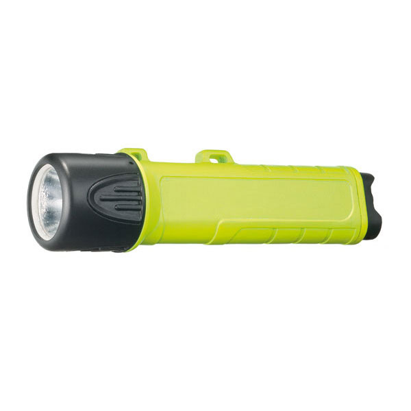

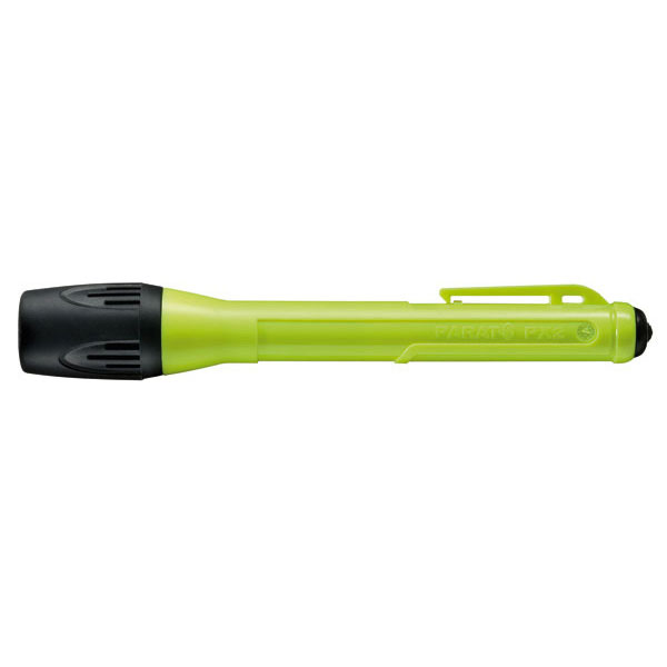

just read an article about Zweibrüder/Led Lenser. They have 3 plants - 2 plants in China. The bodies are made in china, the switches USA the diodes europe the lenses from germany. They have 1000 employees and hundreds of patents and are probably market leader in Led technology flashlights. In just 8 weeks of selling their lights both brothers became millionaire :) .Here`s a report + video (but in geman) with a small insight of their facilities. (the filing cabinet in the video is full of lawsuits with patent infringements from all around the world...).click
heres a company who claims that these 2 lights are made here click
More lights from germany oldschool click :) These probably too, they say they invented the rechargeable flashlight in 1955 www.acculux.eu . The "Mellert" "SLT" range is produced here: click
I bought the UK and Peli ones because you find them often at distributors/wholesalers and Police/Fire department stores and i also didn`t want to spend too much for a Fenix or Surefire etc. "Parat" brand lights you also see often but they`re from china too i think

Just read an article about zweibrüder/led lenser. They have 3 plants - 2 plants in china. The bodies are made in china, the switches usa the diodes europe the lenses from germany. They have 1000 employees and hundreds of patents and are probably market leader in led technology flashlights. In just 8 weeks of selling their lights both brothers became millionaire :) .here`s a report + video (but in geman) with a small insight of their facilities. (the filing cabinet in the video is full of lawsuits with patent infringements from all around the world...).click
more lights from germany oldschool click :) these probably too, they say they invented the rechargeable flashlight in 1955 www.acculux.eu . The "mellert" "slt" range is produced here: click
i bought the uk and peli ones because you find them often at distributors/wholesalers and police/fire department stores and i also didn`t want to spend too much for a fenix or surefire etc. "parat" brand lights you also see often but they`re from china too i think
www.parat.de
sicherheitslampe-parat-px2-xenon-inspektionslampe-im-handlichen-format-mit-cliphalter.jpg
Those parat lights are assembled in China by Pila I believe. Also thanks for the link to that other German flashlight I compiled a list of Made in Europe flashlights on another forum and will add that to it.
