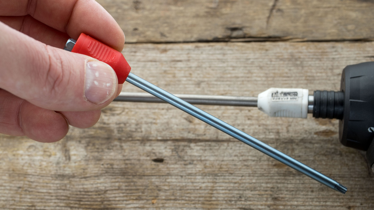

Anex magnets again. Mostly use 150mm long bits at work to reach inside computer cases. Found the magnet gives me enough grip to use the bits like a screwdriver to save me swapping them out for just one or two screws. Saves a bit of time.
Wouldn't want to be without then now. Thanks superautobacs for making me aware of these things. :thumbup:

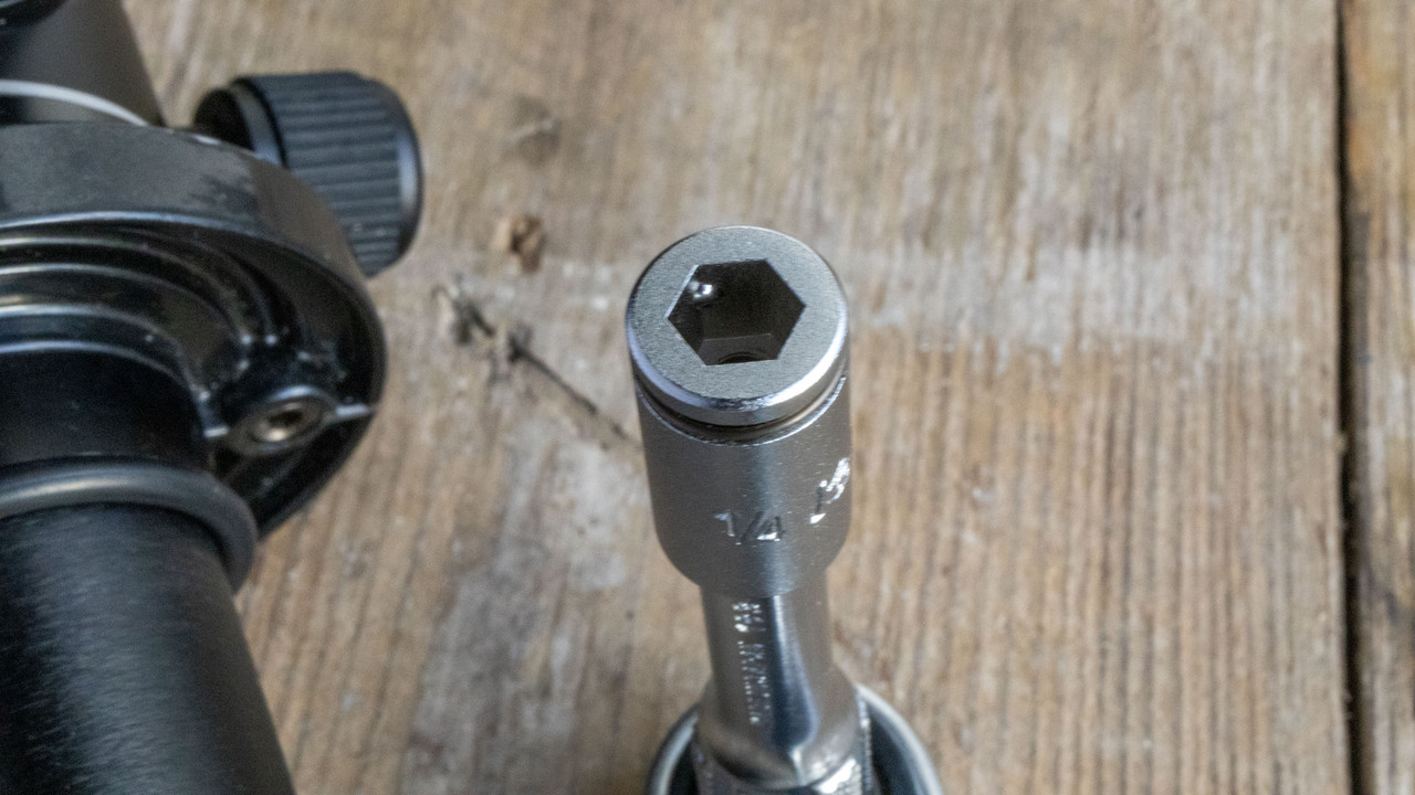

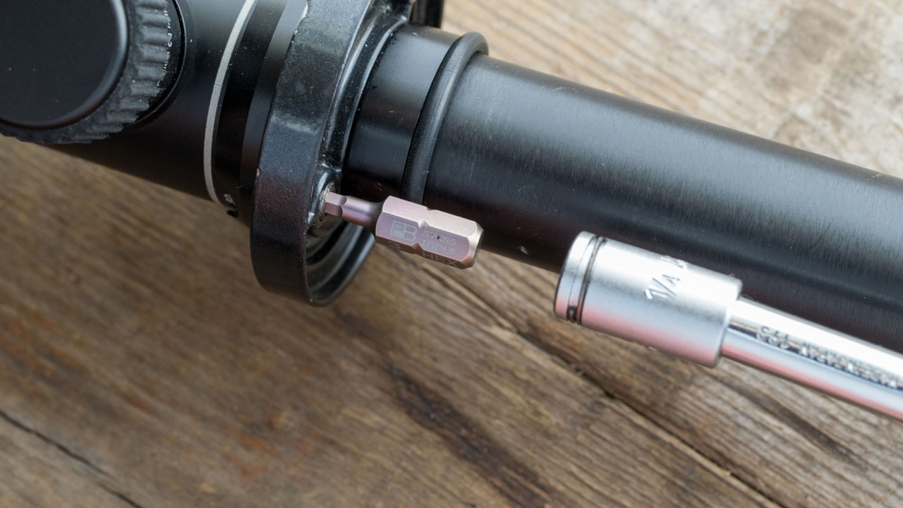

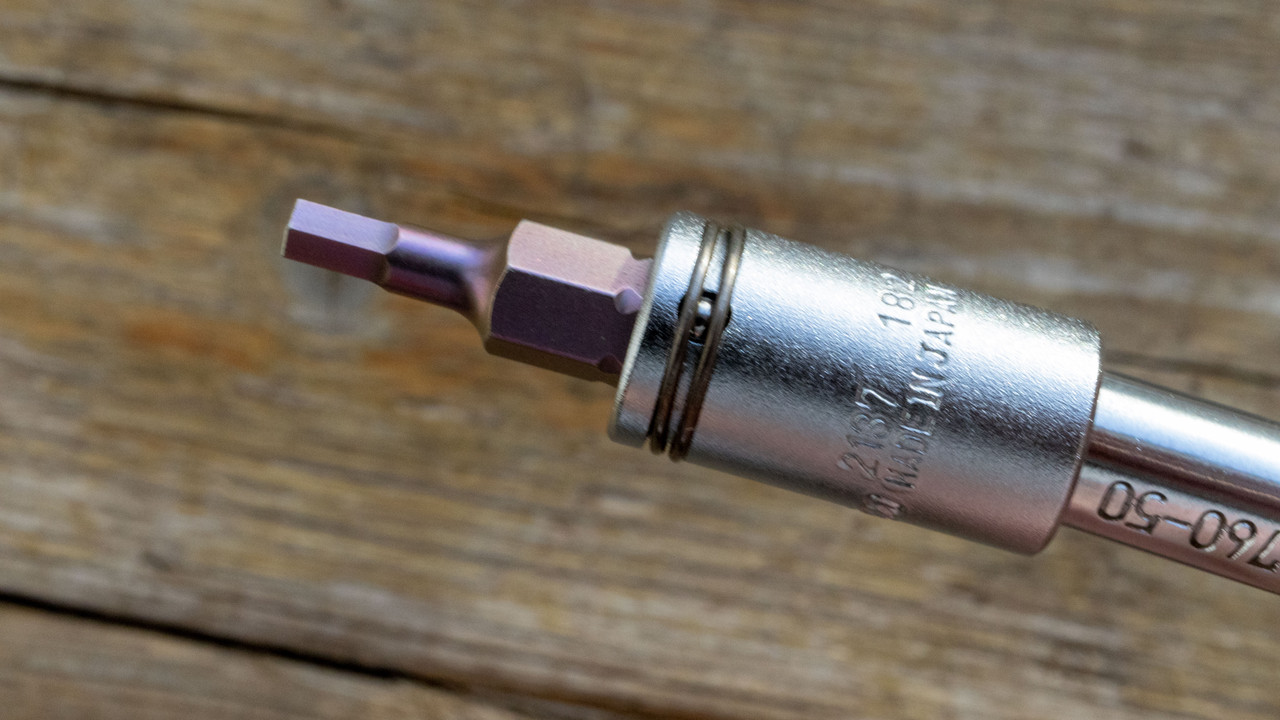

Used a Koken 1/4" square to hex bit adapter and found it to be not fit for purpose as it does not retain bits. Bits keep sticking in fasteners. Recently talked about Japanese power bits being different, are Japanese standard bits different too?
Ball inside to retain bits.
Bit does not go in deep enough for the ball to line up with an indent.

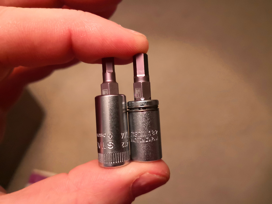

Thanks for pointing out the Japanese reviews. Thought I was missing something. :headscrat
Koken next to Stahlwille. The Koken is shorter so I thought it may get into smaller gaps with less clearance but with bits inserted they are both the same length. Curious indeed.
Got to wonder if it was designed for some special low clearance bits.

Pulled up the catalog page from Ko-Ken. On the lower left, it shows the DIN/ISO standard.
