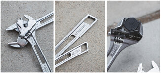

I received a Amazon Japan order the other day, which included a couple of items that I haven't seen mention in here very much. I'm find them impressive (especially given their prices), so I figured I'd highlight them a bit for anyone else that may be interested in them.
They are the Merry screw-extractors, and Lobster adjustable wrenches.
First up, Merry (Muromoto)...Engineer and Vampliers seem to get all the love, but these are brilliant. Incredible fit and finish, great ergonomics , and damn fine looking to top it off. A couple quick grip test proved very promising.
Then the Lobsters.
I've always detested adjustable pliers, and actively avoided them at all cost, but my recent foray into the world of Knipex plier wrenches left me feeling underwhelmed, and slightly disappointed. Thus, leading me see what the fine makers of Japan had to offer...and they did not disappoint. Silky smooth mechanism, a negligible amount of play, comfortable, well balanced and extremely light weight. And best of all...the shape of the fixed jaw. That third point of contact really seems to up the ante, fitment wise. All in all, an adjustable wrench that I'm willing to use
Here is the entire order, for those that are curious

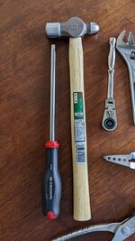

anyone have a reliable source for canvas saw covers? Hida is on my list, but someone else must sell them, too.
also, @m6z, a link to the ball peen hammer please & thanks?
