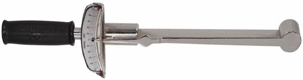

Tools that rarely get used anymore
67King
Nov 14, 2014
577
Friendsville, TN (Knoxville area)
Pneumatic ratchet, drill, and impact have all been replaced by cordless versions. I don't even keep them in the toolbox any more.
The other thing is a distributor wrench, but given that I still have a couple of old cars (66Bronco and 67GTO), I shouldn't really say that. But neither are running, and I hope to have both converted to electronic control when I get them that way.
Davefr
Jan 7, 2010
11,822
OR
These. So common but almost never used:
speed bump
May 28, 2008
6,317
Butte Montana
Slip joint pliers
Hack saws, couldn't tell you the last time I used one.
Sadly welders, until last month I went almost a year and without ever using my Lincoln 255c.
Files
Sunset_Z28
Dec 27, 2014
331
Harrah, OK
I definitely agree about slip joint pliers. There are much better pliers made nowadays. As far as a speed handle goes, I still use mine when dropping transmission pans. My radial arm saw is one tool I never use anymore.
wafrederick
Jul 3, 2010
6,045
Holton,Mi
Spark plug cleaners and tools to replace cv axle boots.Spark plugs don't get cleaned and reused over again,get replaced with new spark plugs.Same with axle boots,can get a new axle these days now.
curtrnev
Apr 13, 2009
173
This. Still have mine. Can't make myself part with it.
I remember when they switched from metal cans to the paper style cans . My dad would get pissed off when the side would collapse if you didn't stick it right the first time.
Kent_B
Jul 4, 2013
1,406
MI
Axle boot tools are a rarely used item. Howeer last year, I had a damaged CV boot and the joint was fine. I didn't see the need to spend $100 for an axle when I could reboot it for much, much less. Those pliers came in really handy.
krux
Jan 21, 2012
468
na
Gosh I use my vice grips all the time. Id love to have more.
I bought an oil pressure gauge and never once used it. Also auto body hammers. Thought I would be doing more body work and never needed to.
Sent from my LG-K550 using Tapatalk
SantaAna12
Mar 1, 2012
1,091
I was surprised to run across drum brakes on my wife's car yesterday. I pulled off the rear caliper and rotor as part of a brake job, and inside the rotor was a little drum brake. Apparently that's how Subaru does parking brakes.
Ford too.
CTyankee
Jan 13, 2013
3,792
CT
Good grief, except for the timing light, I use just about everything . Dont get why folks don't use vise grips. When I croak then my kids can get rid of all my stuff. Until then I keep everything.
I like your attitude...:thumbup::thumbup:
SantaAna12
Mar 1, 2012
1,091
Spark plug cleaners and tools to replace cv axle boots.Spark plugs don't get cleaned and reused over again,get replaced with new spark plugs.Same with axle boots,can get a new axle these days now.
"Spark plug cleaner." Hah! Me too.
wafrederick
Jul 3, 2010
6,045
Holton,Mi
Axle boot tools are a rarely used item. Howeer last year, I had a damaged CV boot and the joint was fine. I didn't see the need to spend $100 for an axle when I could reboot it for much, much less. Those pliers came in really handy.
Most new axles are under $100.00.Most of the time the boot is ripped,chances are dirt,water and grime gets in and destroys the joint.Can't get a reman axle these days anymore most of the time.
rapid robert
Oct 24, 2014
156
Upstate NY
How about those old school flat ratchets...they were always to bulky to fit anyway...modern ratcheting wrench have made them totally obsolete. But I still have mine...all SAE.
mbshop
Nov 23, 2010
1,539
visalia ca
Dang, I'm getting all nostalgic here. Kinda sad.
as to slip joint pliers, I didn't know they were obsolete.
Ign
Jul 7, 2006
12,769
Butte Peak ND
Ford too.
Dodge too. DIH (drum in hat) parking brakes are extremely common on all domestic trucks. GM tried some calipers that incorporated the parking brake but they'd always stick. Back in the '70s
99% of trailers still use drums, too. Drum brakes are still VERY relevant
L.Cheapo
Oct 23, 2014
5,899
Its funny...many of the tools people say they don't use anymore are some of my more frequently used tools--timing light, feeler gauges, drum brake tools, window crank tools. Owning two early 70s cars with distributors, carburetors, and 4 wheel drum brakes requires them.
I haven't used my SAE hex bit sockets in a while though.
Farmall450
Dec 23, 2011
13,356
Marengo, Illinois
I was surprised to run across drum brakes on my wife's car yesterday. I pulled off the rear caliper and rotor as part of a brake job, and inside the rotor was a little drum brake. Apparently that's how Subaru does parking brakes.
That's how a lot of manufacturers do parking brakes.
454ragtop
Mar 24, 2008
5,011
Carver, MA
Chrysler ball joint sockets, have a couple that came in a used tool box I bought, pretty sure I've never used them, except maybe in the press...........
dwasifar
May 28, 2017
2,089
Dodge too. DIH (drum in hat) parking brakes are extremely common on all domestic trucks. GM tried some calipers that incorporated the parking brake but they'd always stick. Back in the '70s
99% of trailers still use drums, too. Drum brakes are still VERY relevant
So I'm learning. My last two cars have had cables to the rear calipers instead, and before that I had a series of leased cars that I didn't keep long enough to do brakes, so I had just never encountered that design until the other day.
The first of those two had problems with sticky calipers too, so go figure.
larry_g
Apr 28, 2007
16,874
oregon
Seen two tool in my box today long past use, GM flex shaft hex key for adjusting points and a set of piston ring groove cleaners.
lg
no neat sig line
keen
Sep 12, 2010
125
geneva, fl
Most new axles are under $100.00.Most of the time the boot is ripped,chances are dirt,water and grime gets in and destroys the joint.Can't get a reman axle these days anymore most of the time.
not all cars have quality reman or new axles available at that kind of price. bought the -only- new replacement axle on the market for one car once (dealer was the only reman source at 8x the price). less than 10 miles before the joint exploded, leaving the car stranded since no limited slip, zero wheel drive...
ended up tracking down a good JY axle, 5 years later still rolling to my knowledge....
Mikeske
Apr 28, 2017
2,125
Washington State
This tool is not used much anymore and I had it for at least 40 years and it was at least 10 years old when I bought it out of a pawn shop.
  • fullsizeoutput_d1a.jpg
    8.1 KB · Views: 117
Mikeske
Apr 28, 2017
2,125
Washington State
This one here is way better. You can press your palm against it for maximum downward force. Pop a bit socket on the end and it's outstanding for structural wood screws.
. I used those for years on aircraft, I used to get in contest with kids using air tools on removing fasteners from the aircraft (like under the wing) I would win just about every time using a speed handle as you get good pressure and you feel when a fastener might strip and then break out a Lester tool and use that to start it off and the speed handle to finish removing the fastener.
