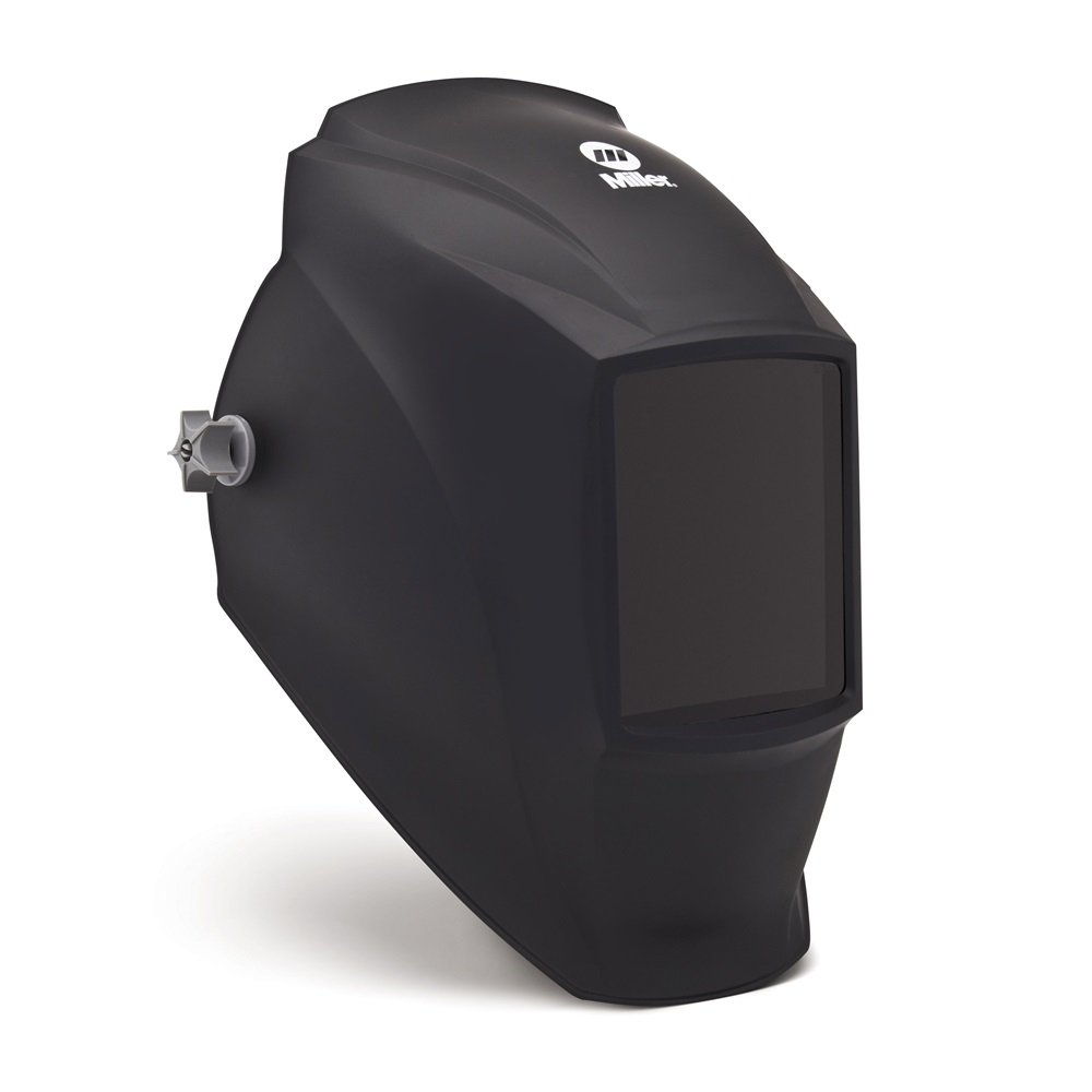

For a mask I would just get a regular non auto darkening for now if you want to save money, because eventually down the road after you buy a nicer one you will still want something less expensive for grubby work. If you buy a cheap auto darkening look for one with at least 4 sensors and replaceable batteries, I have a cheap Lincoln with 2 sensors and solar powered only and there was a 30% chance of getting flashes which left your vision piss poor for the rest of the weld. Upgrading to the Lincoln viking 3350 was the cats *** but a good fixed shade protects your eyes equally well

hopefully a fixed shade isn't so dark that it makes seeing anything until the weld starts impossible
like pulling down the visor then trying to find the area visually that needs welding before pulling the trigger
unless maybe a flashlight could help

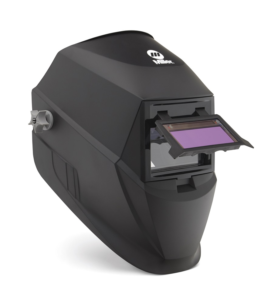

was looking at this one
sounds like you're saying it might not be good due to 2 sensors
is however battery powered and not solar I think
https://www.millerwelds.com/safety/...title=classic-series-fs-10-2x4-flip-up-263038
$99, Classic Series, FS #10, 2x4 Flip-up
if anything was just going off of trusting the brand reputation
they also have $44 non auto darkening MP-10™, Black
https://www.millerwelds.com/safety/helmets/mp-10-series-welding-helmets-m00473

At least an 80cuft cylinder, a 150cuft would be better.... an auto dark hood for a new welder to learn with is the best way to go.... Miller, Jackson, Weldmark, are a few good ones I can think of.... Later, as you get more comfortable with welding, pick up an extra cylinder so when you run out of gas late on a Friday nite and cannot get a refill till Monday you are not stuck unable to work..... :dunno: :sad:

My skills jumped big time w/ auto darkening lens, wear cheater glasses under helmet, spot light on the work.

The HTP welding helmets are good for the money but the Lincoln ADF helmets are much much nicer and last way longer but for a first lid the HTP is probably a good bet. I have a Jackson Safery fixed shade helmet, headgear is really nice, way better than HTP but as a beginner I'd get an ADF first.

Buy a good helmet, seriously just spend the $250-300+ now. Go to a welding shop and try on stuff (make sure its comfortable) and ask their advice on what a good helmet is. The difference between $50-100 hood and a expensive hood is hard to appreciate before you have done any welding you will thank yourself for saving that $100 one day in the future.
