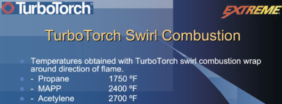

I ended up buying the Mini-Ductor II on sale for $375. For anyone else finding this in the future, I found this presentation which is informational around the various Turbotouch Extreme products: https://hvacrassets.net
Excerpt: Screenshot 2023-06-24 at 1.05.10 PM.png
